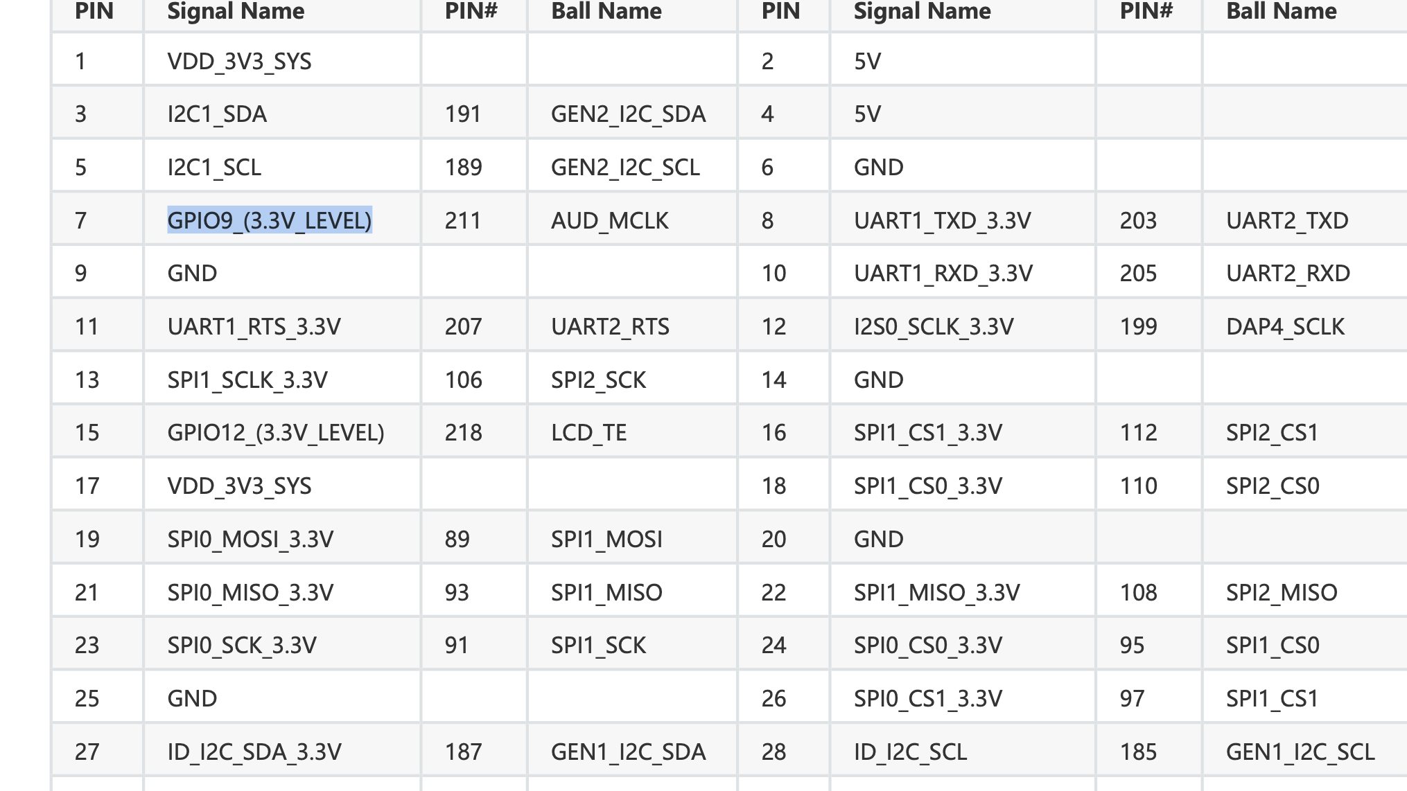

Hello,
I am trying to turn on some GPIO pins on my Jetson Orin NX A603 board. I see the datasheet lists these sorts of pins which align with the physical ones:
Since it seems that Jetson.GPIO doesn’t work on the newest Jetpack, how do I find which pin is which for using gpioset to turn on some of the GPIOs?
