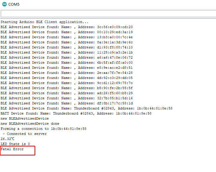

But,When I make the read and write project together, then occur a Fatal error。
I do not know how to manage more than one serviceUUID or characteristicUUID.
Can you give a example?
