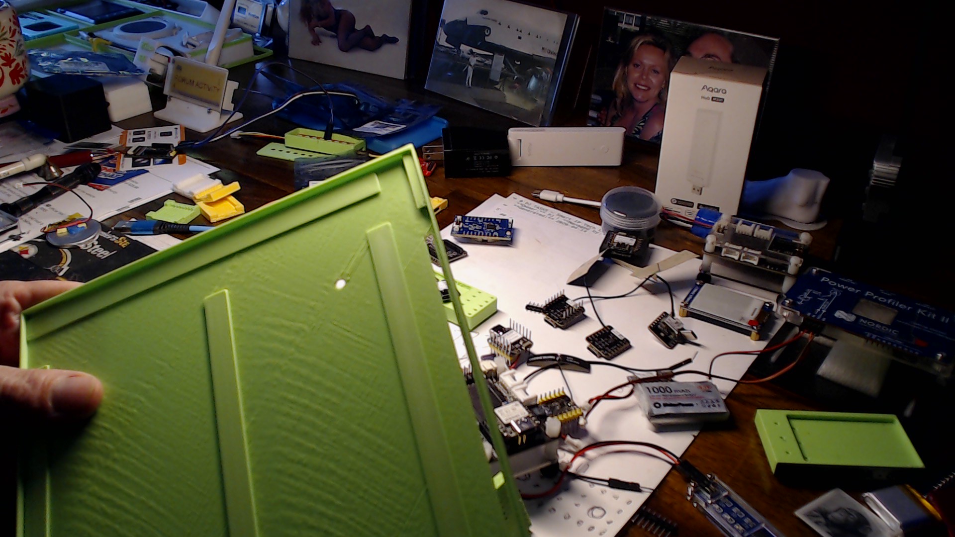

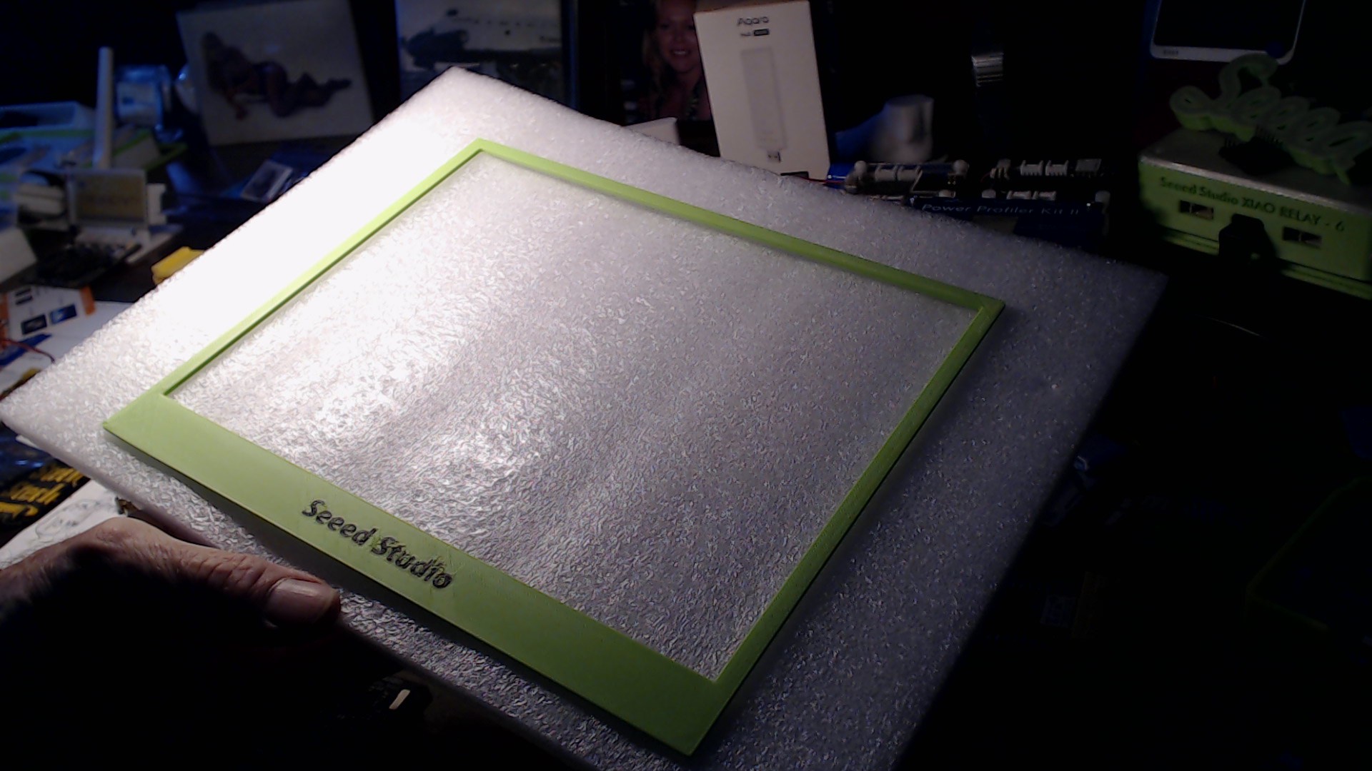

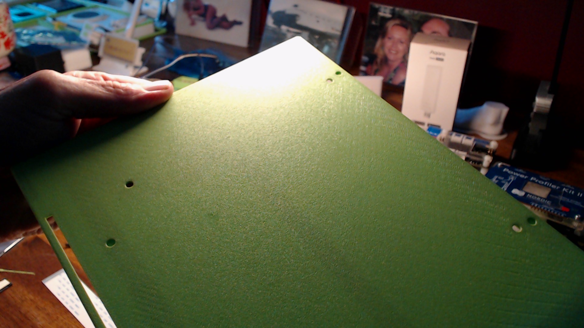

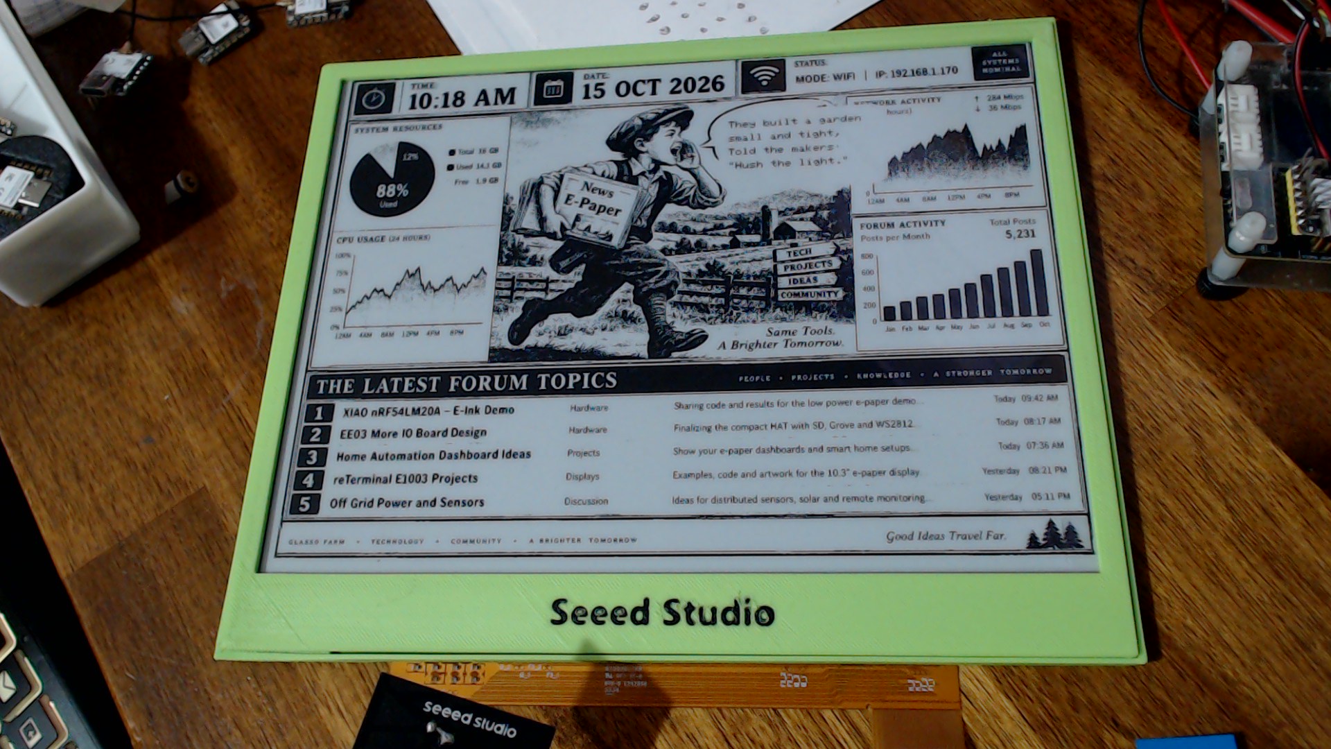

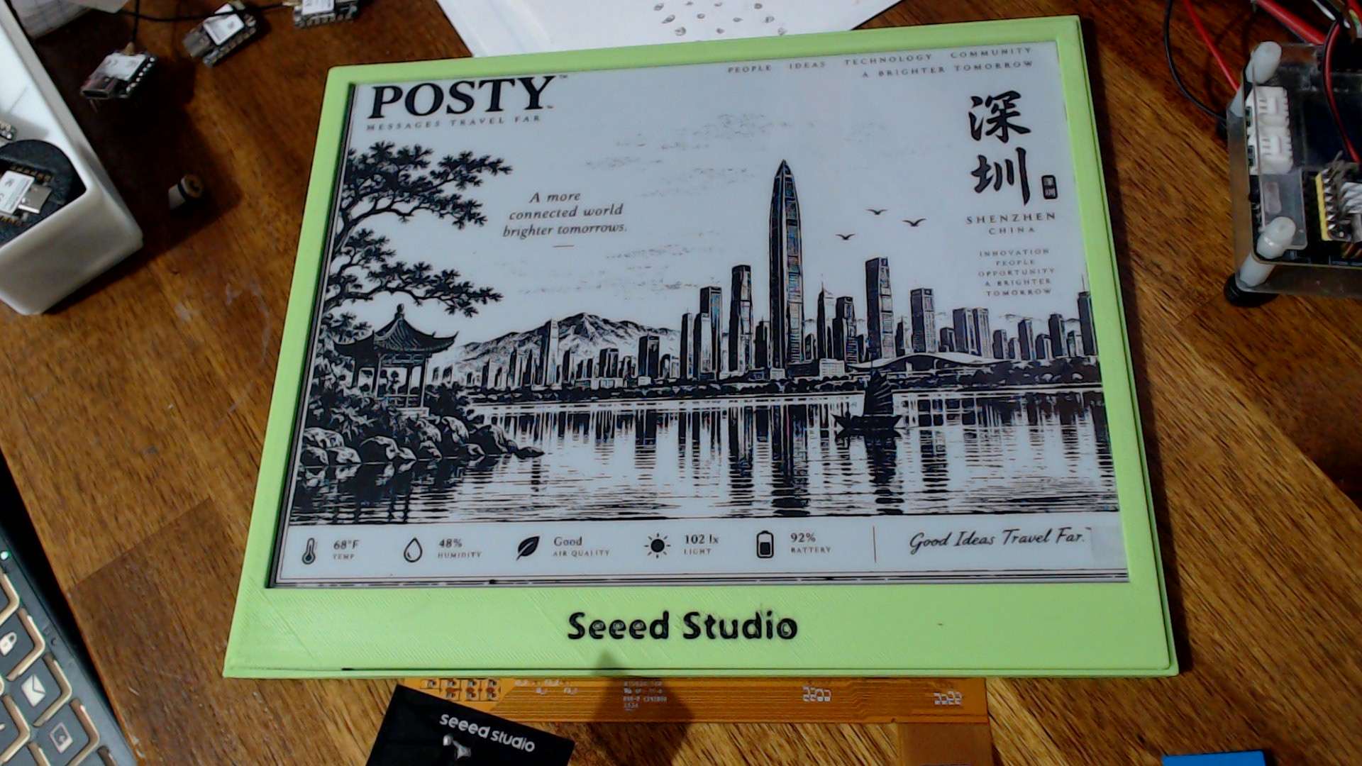

Back printed very nice and the Bezel is next
Stay tuned for more…
Unbox, Packed Very, Very Well… :grin: :+1:
Printing the Back Shell , fused the supports so it prints as one Piece.

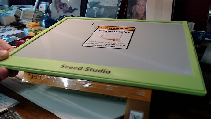

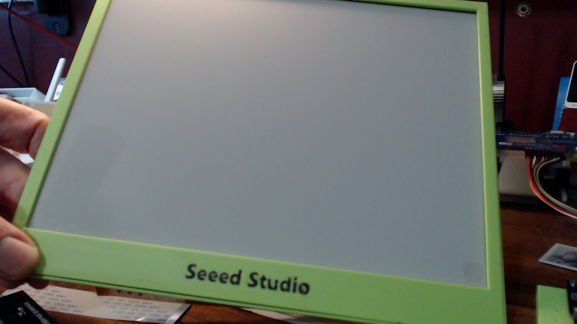

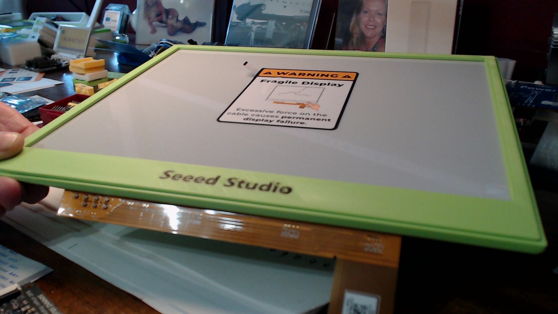

The Bezel looks great , fit is Perfect Props on the STP. File contents
:grin: :+1:
I added some Branding…

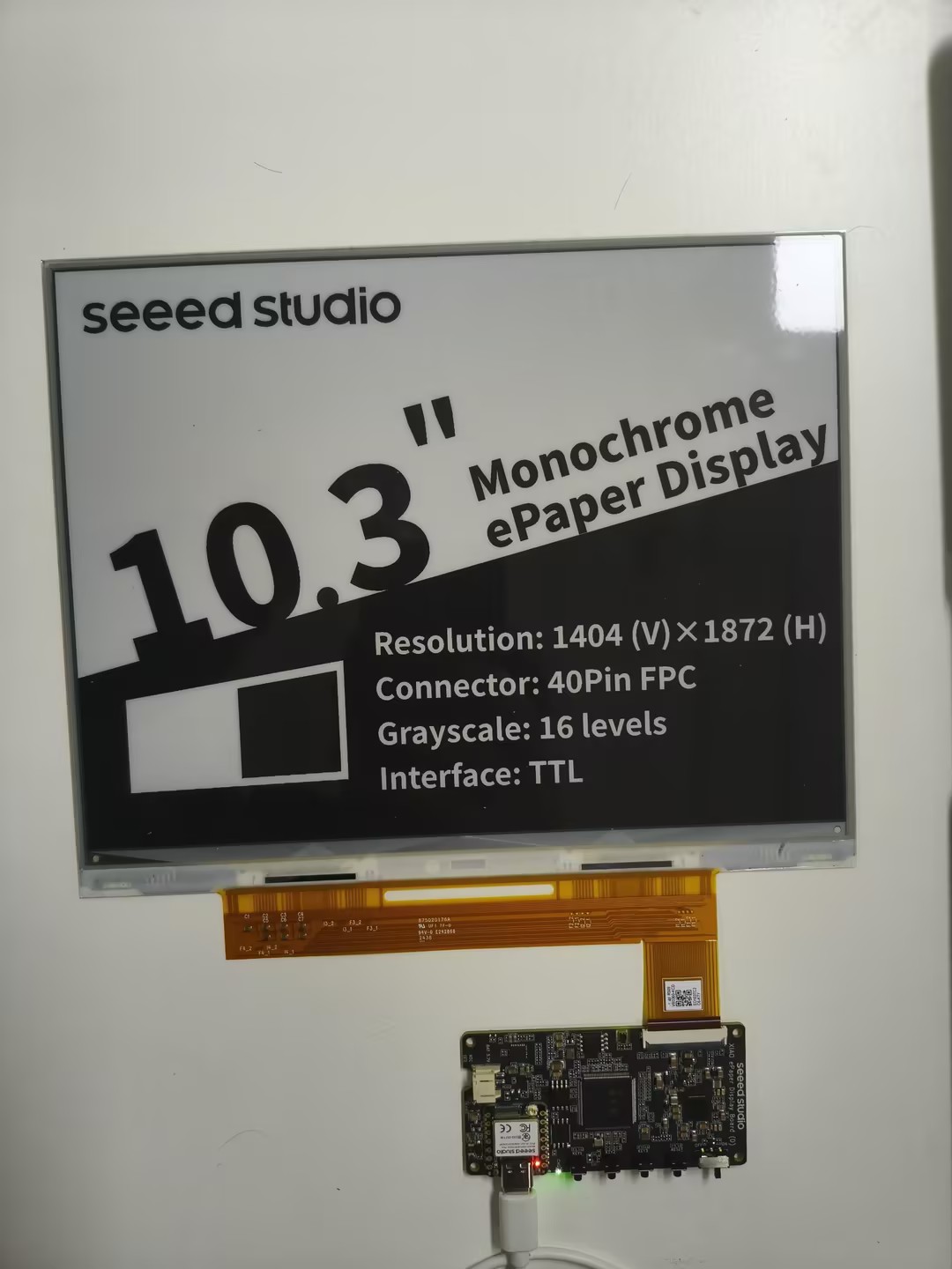

Whenever the image WON’T update and appears frozen, the ee03 is still functioning fully and flashable, only the display is frozen
I see some users had this too.
Turns out the cable that ships with the unit is the culprit. it’s 1" too long per the spec’s and when you send it text it is not a problem, BUT
send one of these SWEET :grin: Photo’s and it may hang tighter than two coats of paint. M|ine did exactly that and was repeatable.
TO fix it, I removed the EXTRA piece and connect directly to the ee03 , load the factory flash and do the Deep clean /DE ghost process, and it comes back AOK,
Reflash and it runs perfectly (with no extension cable) is what I find.

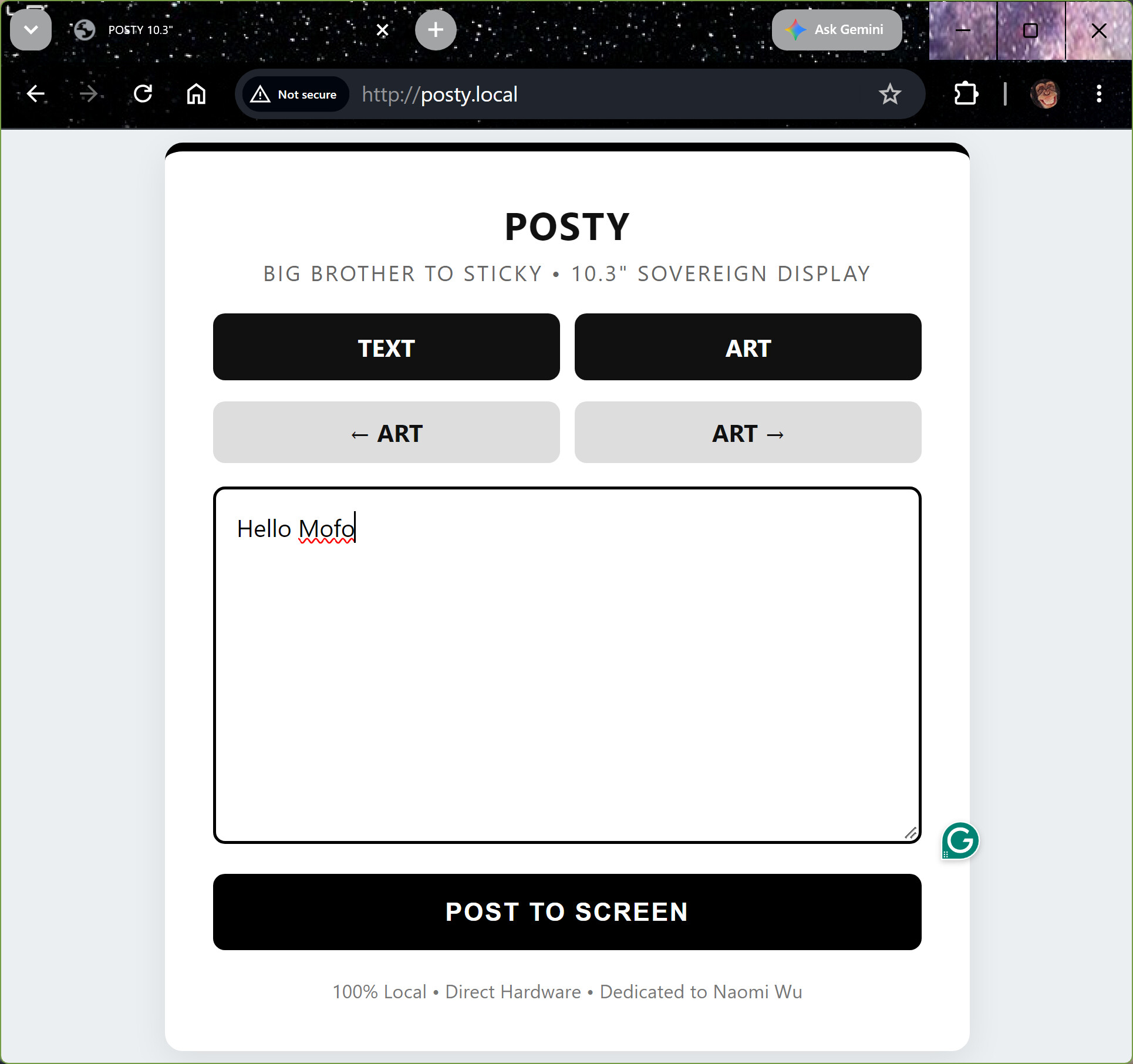

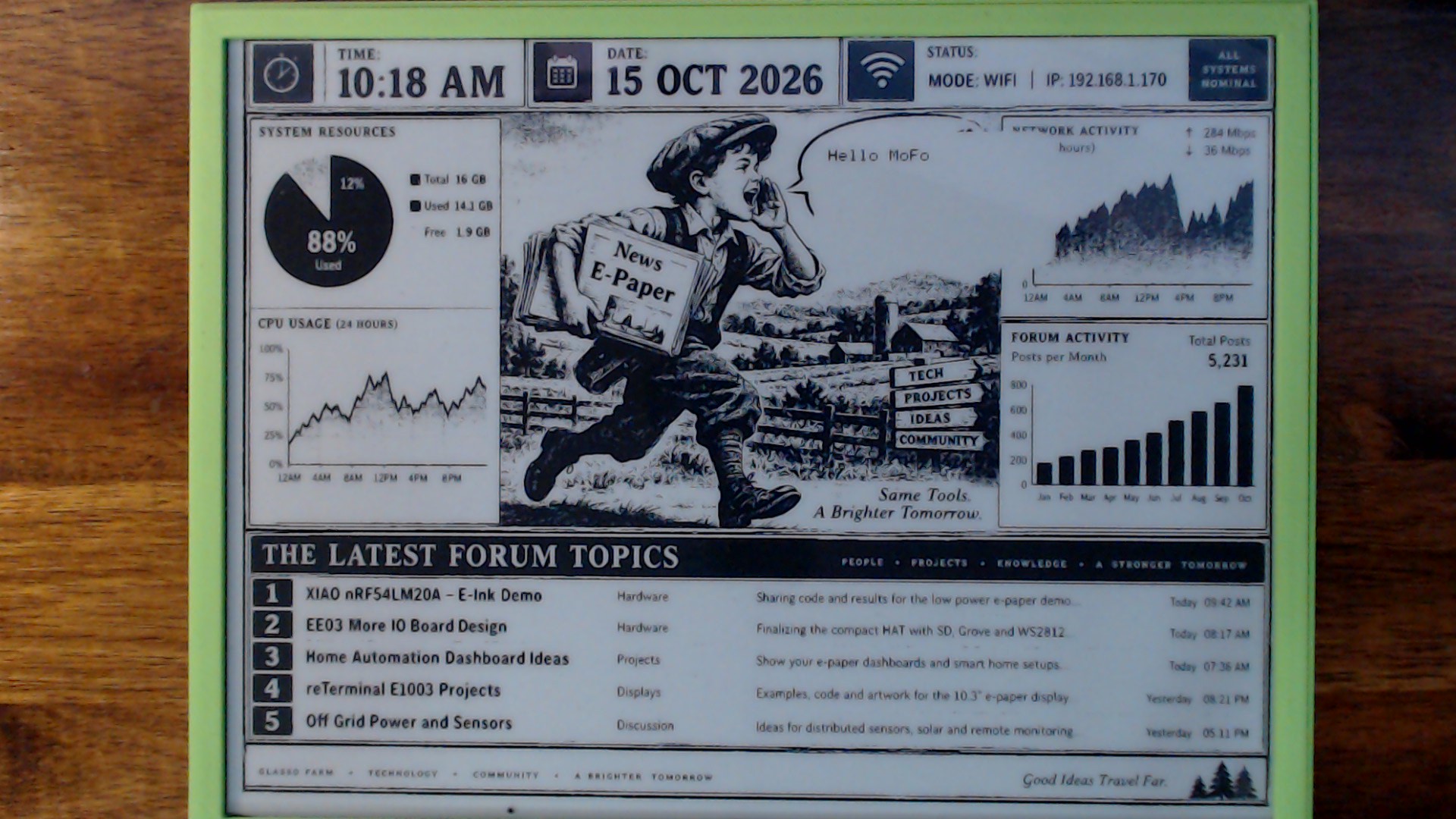

here is my version…No account sign up, no only works 100% if there’s internet.
“POSTY” the unofficial “STICKY”
and YES
:grin:
it’s Better!

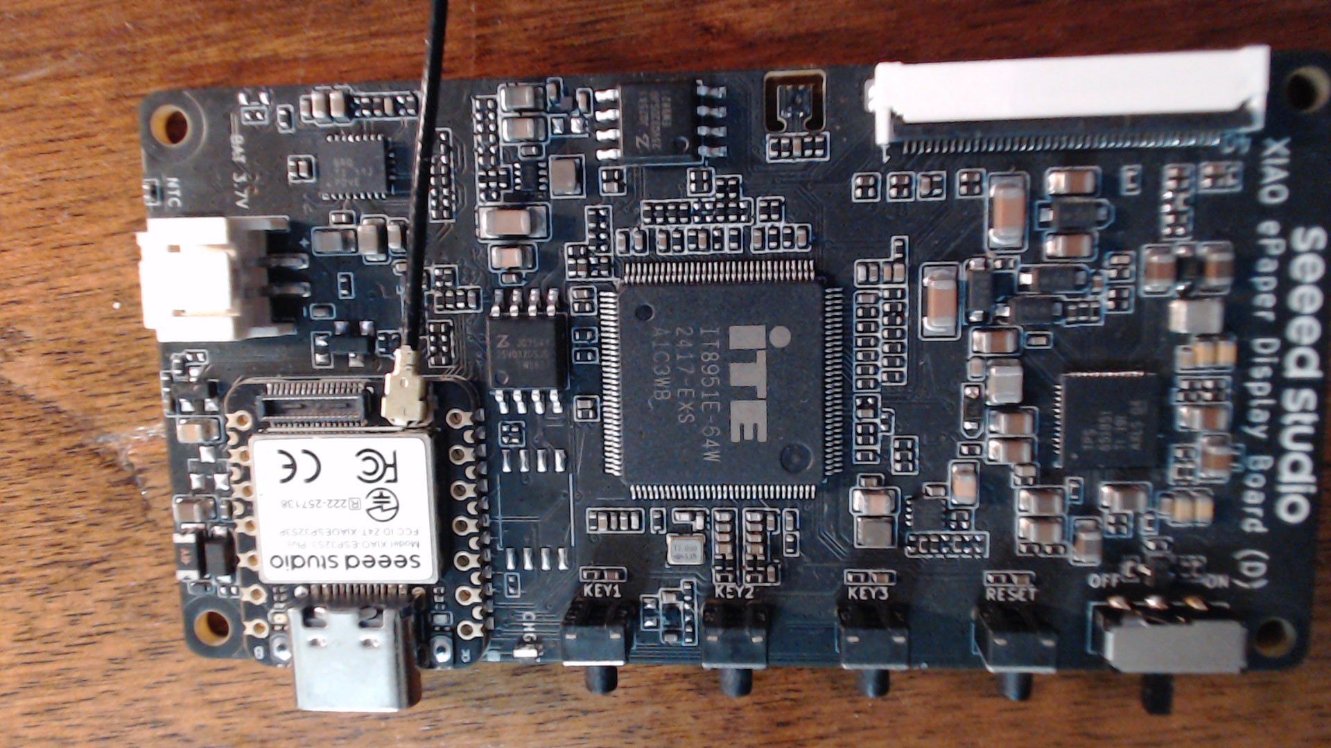

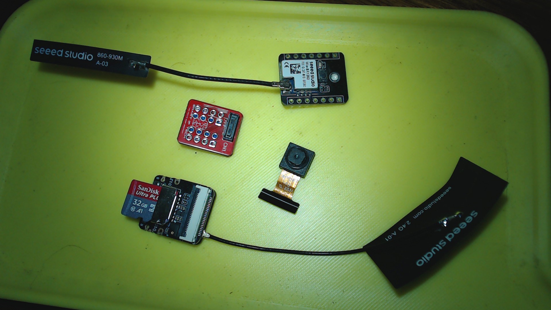

The push toward mandatory cloud ecosystems like SenseCraft/Seeedash turns perfectly capable, power-efficient hardware into an internet-dependent terminal. Relying on an external cloud broker to push a frame to a local 13.3" Spectra 6 display or 10.3" Mono Hi-Res completely ignores offline reliability, zero-latency local updates, and data privacy.
Using an [EE02 Driver Board] or EE03 Driver Board (https://www.seeedstudio.com/XIAO-ePaper-Display-Board-ESP32-S3-EE02-p-6639.html) with an onboard XIAO ESP32-S3 Plus while trapping the high-speed storage potential makes standalone dashboards unnecessarily difficult. A dedicated daughterboard carrying a local micro-SD interface solves this by serving full-color 13.3" Spectra 6 bitmaps, cycling dashboards locally, and pulling directly from local networks (ESPHome/Home Assistant via MQTT) rather than a remote cloud service.

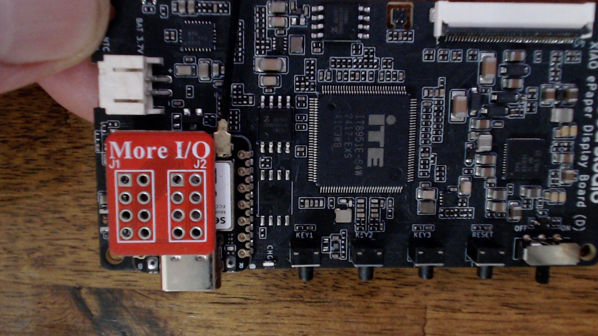

Honestly Idunno if they are just cranking stuff out and no-one looks close enough to see what opportunity for additional product functional enhancements are ignored or not considered. Baffles the mind. I see this more and more, no synergy for what work they have already done, Here for example the S3 Sense product has a daughter card for the camera and an SD slot. That SD should be compatible with all the B2B based S3 or Plus designs there after, only requires someone to audit the pins they are using in a professional manner. i.e. Don’t be LAZY :wink:
Same situ, with the LORA board, (one pin) keeps that from a PLUG and PLAY Lora capable display. WTH guy’s and GALs?
POSTY_V2_1_Posted.zip (524.2 KB)

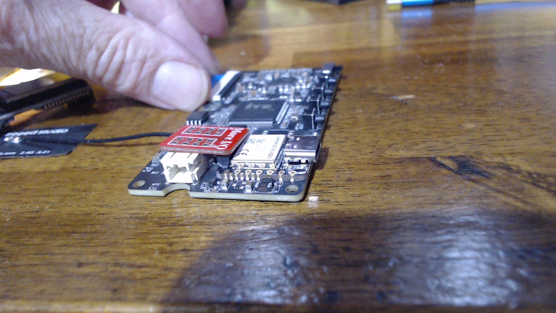

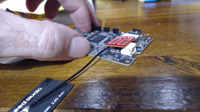

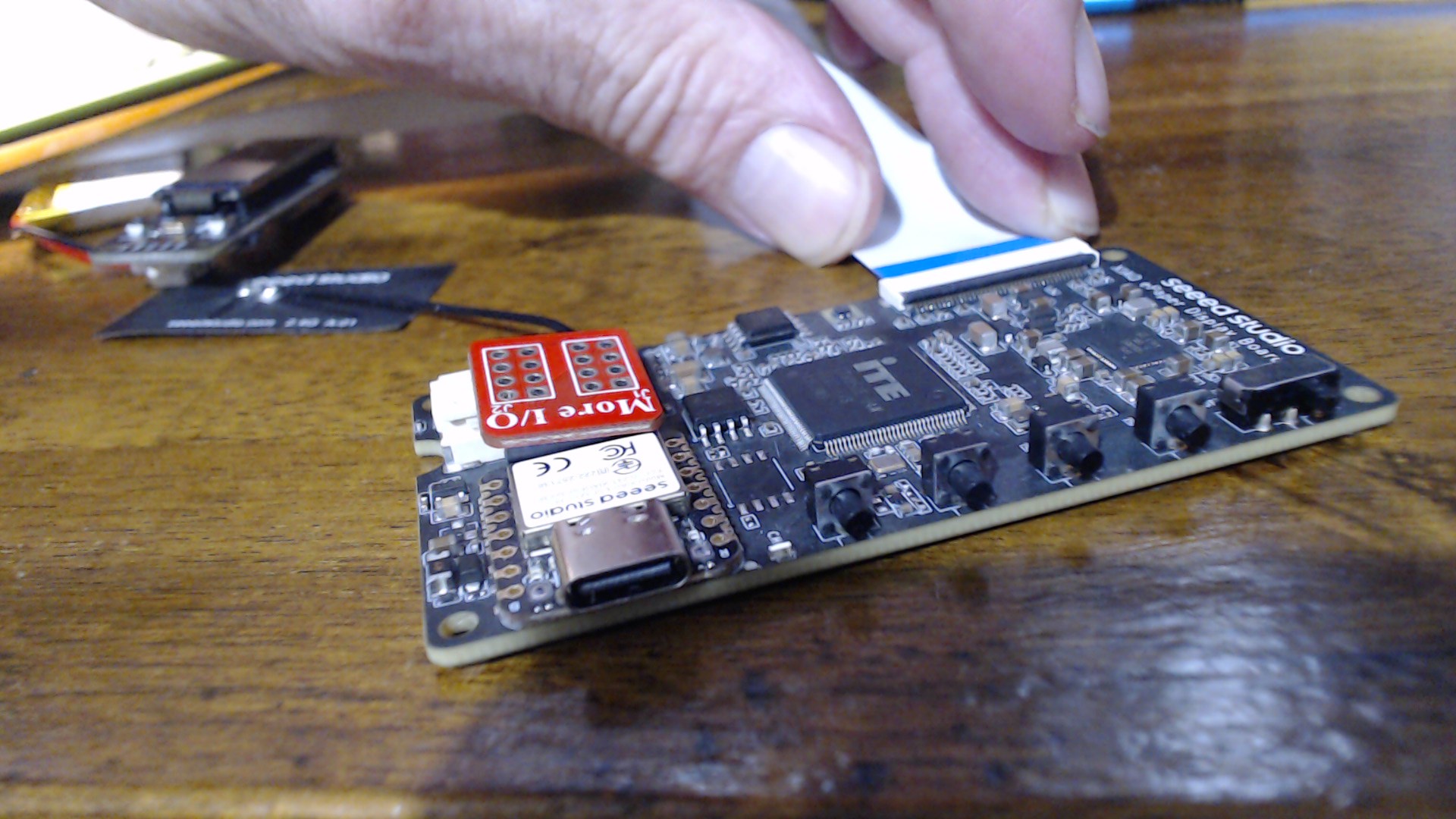

So , this is all they need to make any S3 or S3+ based board , i.e. EE02 or EE03 a banger IMHO :bow:

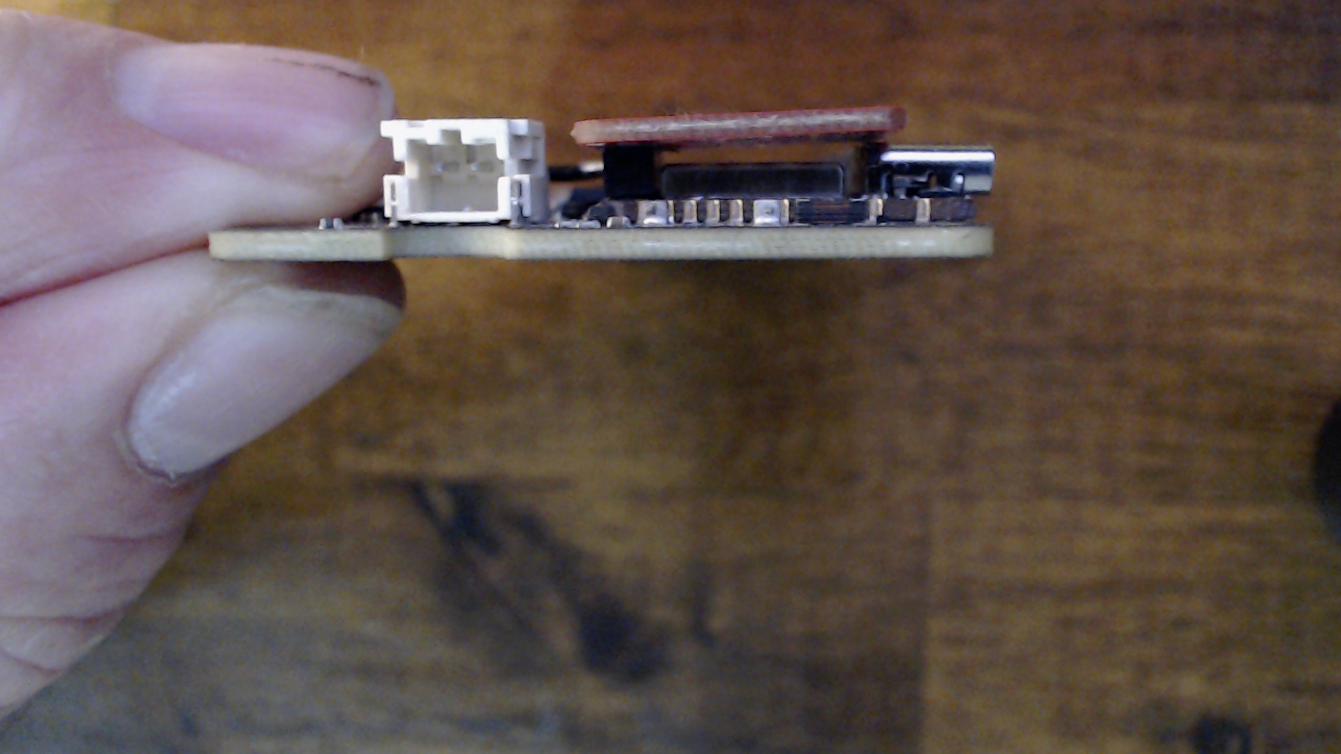

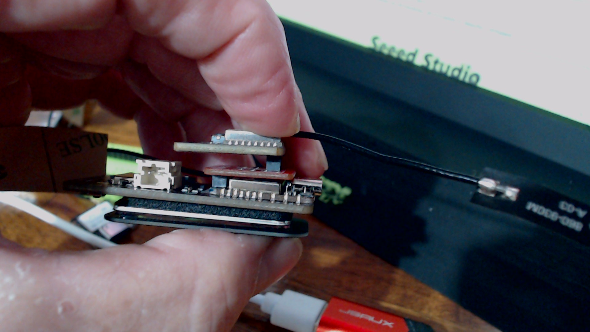

can’t use my MORE_I/O daughter card , it hits the stupid battery connector.
(180, causes pin issues) I’ll make an Interposer that passes through and flips things correctly. coming soon.
You have this…
You add this…(or one like it)
use this for now…
add some wires, code and SD card and Bob is you uncle.
:grin:

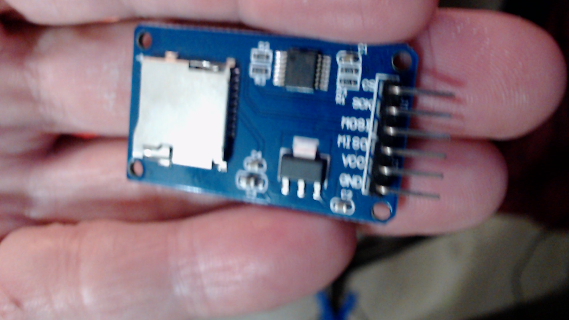

How many pics you want ?
interposer for LORA board, makes any S3 or S3+ (lora connected wireless display)

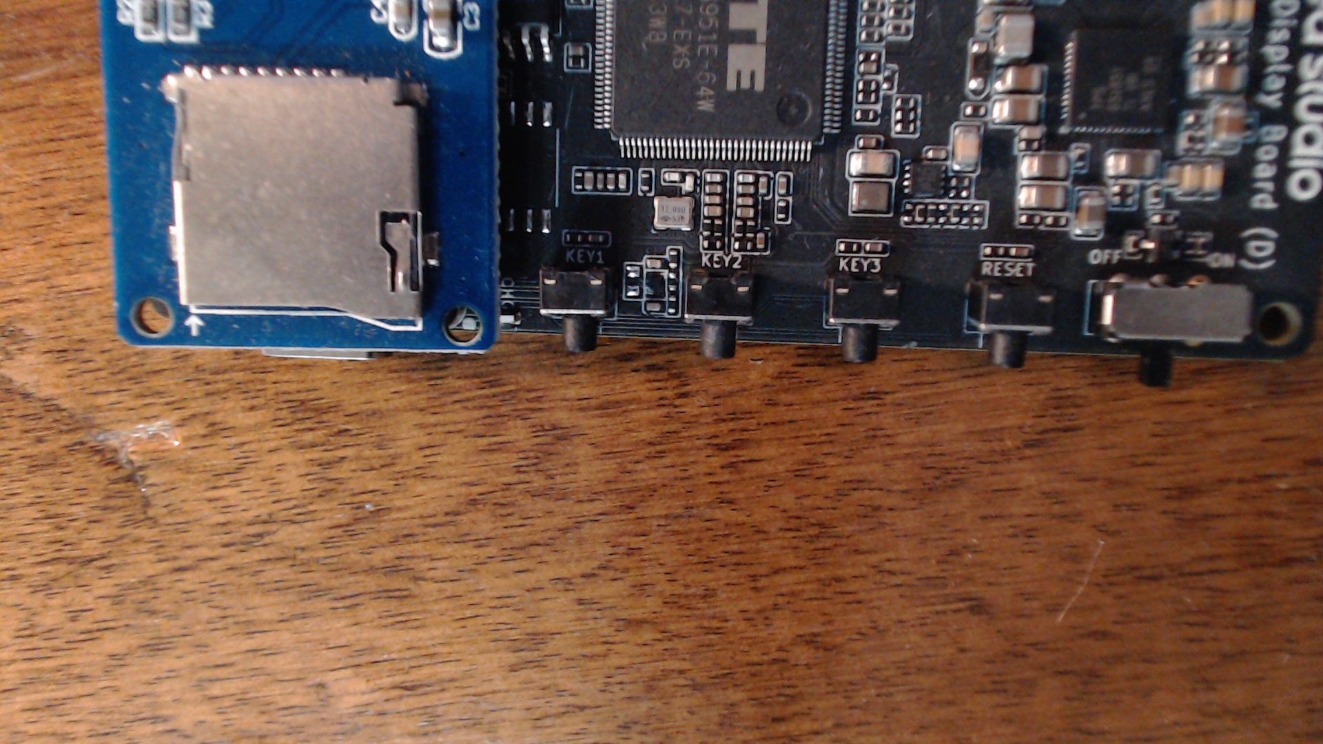

SD Daughter should work but doesn’t , why ?
PINS
the wrong ones. :face_with_open_eyes_and_hand_over_mouth:
Should be a simple as this to Add external SD or LORA or more I/O to Xiao S3 and S3Plus… C’mon man (ESPN) fumbled the BAG :money_bag:

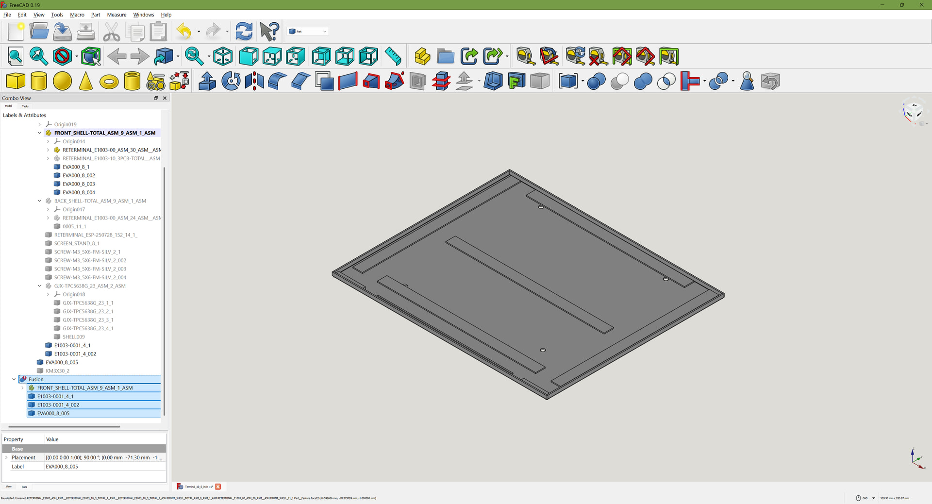

Sure it’s the same from the Wiki, for the 10.3 " epaper display,
at the bottom under resources, there is a link to the .STP file.

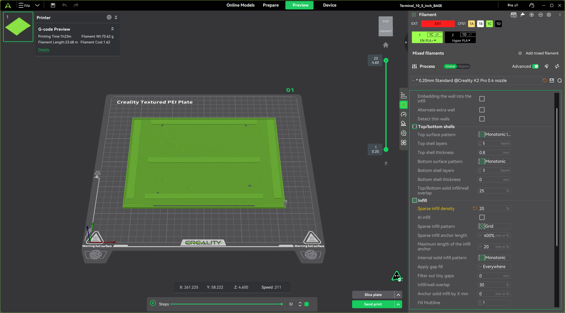

I added the “Seeed Studio” branding in the printer slicer (k2-Pro), under the engrave text tab. :grin: works like a BOSS.

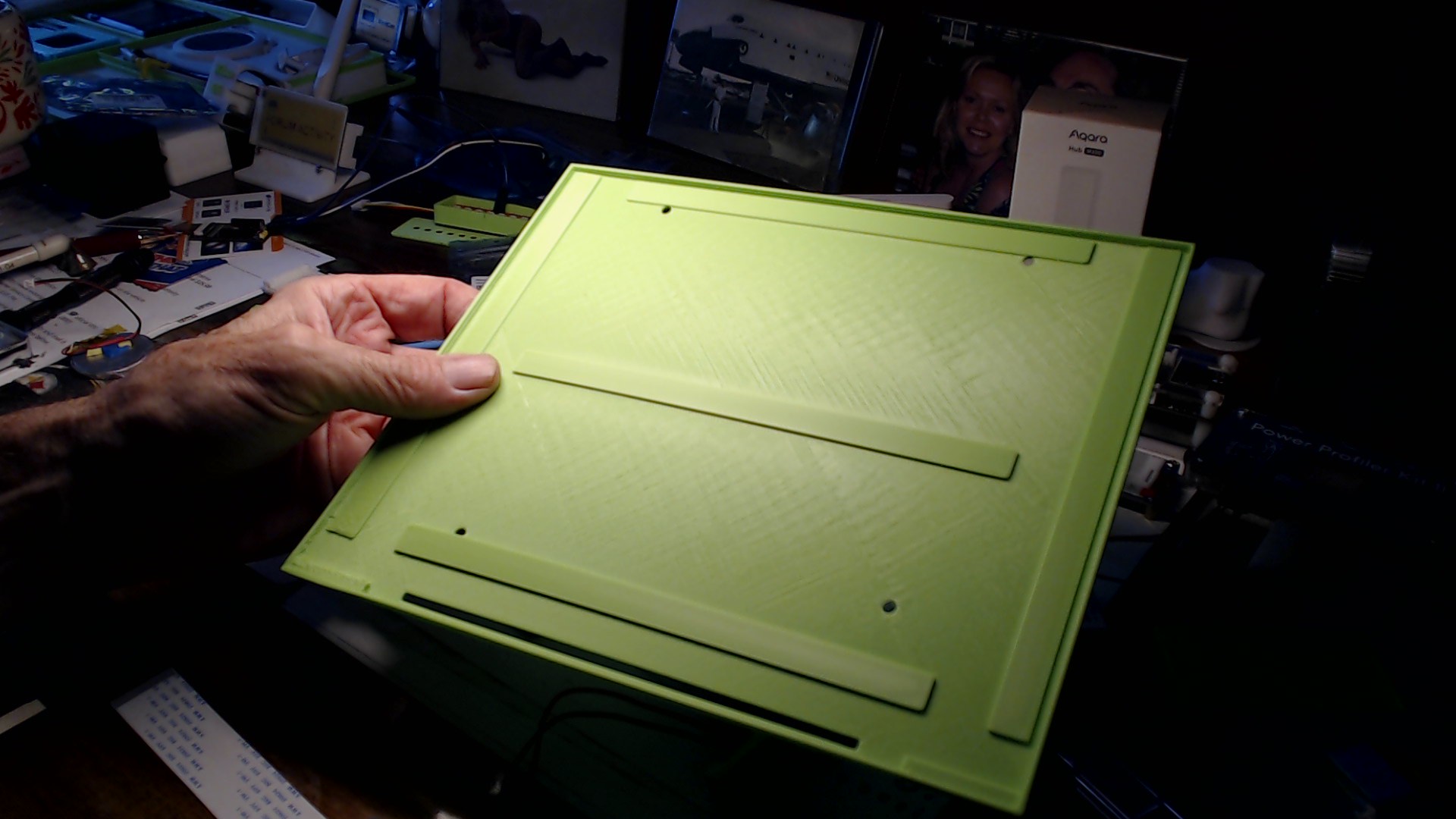

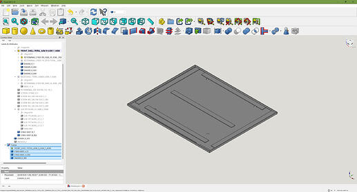

I did’nt use the Base though as you can See , I rolled my own (Angle) :wink: in FreeCad
the stand for the 4.3 inch works on this one too. so that is an option. The Base is a WIP, or you can use the Back(stand) peg they provide?
here are some of the STL,'s if that is easier, just look it over and check layer hights etc. some of this was experimental.
Terminal_10_5_inch_Base_Stand.zip (912.6 KB)
