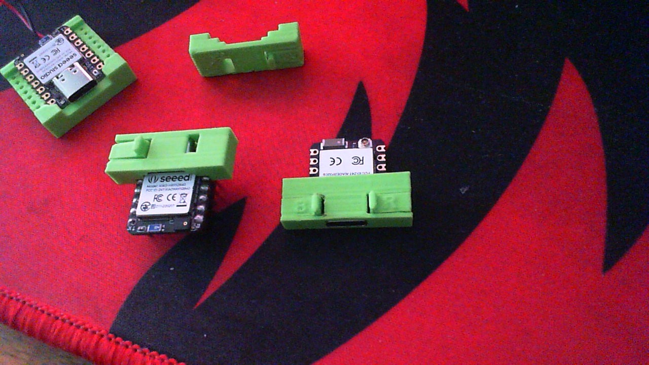

I’m using these for when button pushing is the only tech available.:cros
Big_Buttons
