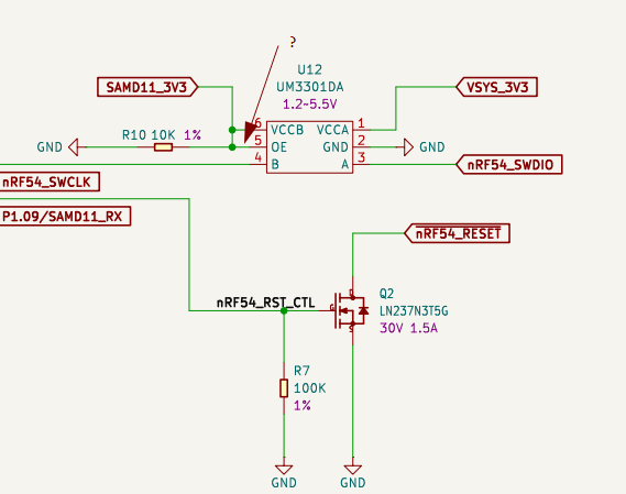

Regarding my XIAO_nRF54L15, it’s highly likely there’s a hardware issue.
I’m observing signal levels by placing a digital scope probe on the SWDIO and SWCLK pads on the back. The SWDIO pin on the XIAO that cannot upload remains constantly LOW with no changes. The SWDIO pin on the XIAO that can upload is normally HIGH and changes between HIGH and LOW according to the data.
Referring to the circuit diagram, I suspect there may be an unstable connection.
U4 (ATSAMD11) PA02 <----> U12 (UM3301) B
U12 (UM3301) A     <----> U6A (nRF54L15) SWDIO
                   <----> SWDIO pad.
Good work!
Wow, that’s some solid troubleshooting, and makes logical sense.
I would suspect that there’s a bad connection to one of the mcu’s.
As a normal customer I would 100% request a return on the flaky one.
But I’m not normal!
As a curious tech geek, I’d void the warranty trying to reflow the board to see if it fixed it, and share the results.
–Toastee

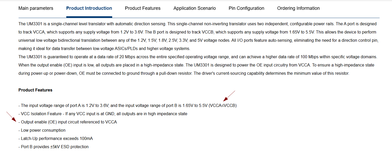

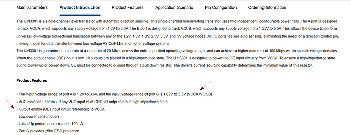

I think it “could” be that the OE for the UM3301 is supposed to be referenced from VCCA to enable the isolation of the SWDIO signal.
The circuit diagram shows a VCCB reference.
Another potential “issue” could be if the VCCB is not >= to VCCA (when USB plugged in).
To test I would power the XIAO with 3V3 (not USB, VBat or 5V/VUSB) and see if SWD (underside pads) works.
Unfortunately, I don’t have any XIAO NRF54L15 to test any of these “theories” on (or with?)… or on which to test any of these theories :thinking:
