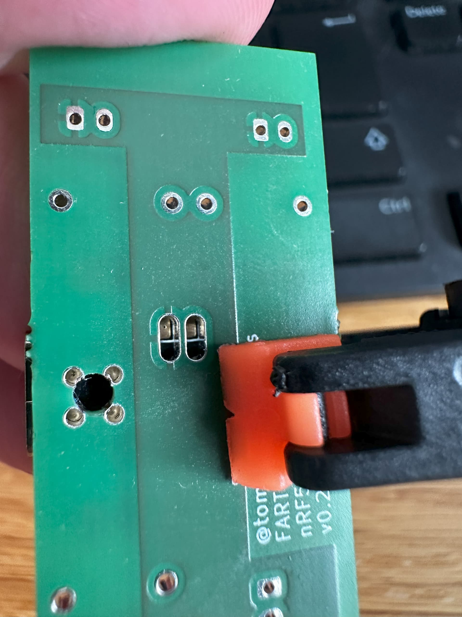

Thanks again! Is that necessary if you have a hotplate or oven to solder it with, or is this just for trying to do it by hand?
So mostly for by hand, but you’ll need to apply paste to both the stencil for the board and on the Xiao’s Batt Pads Only… YMMV but I get :100: percent success when applying this tech. :crossed_fingers:

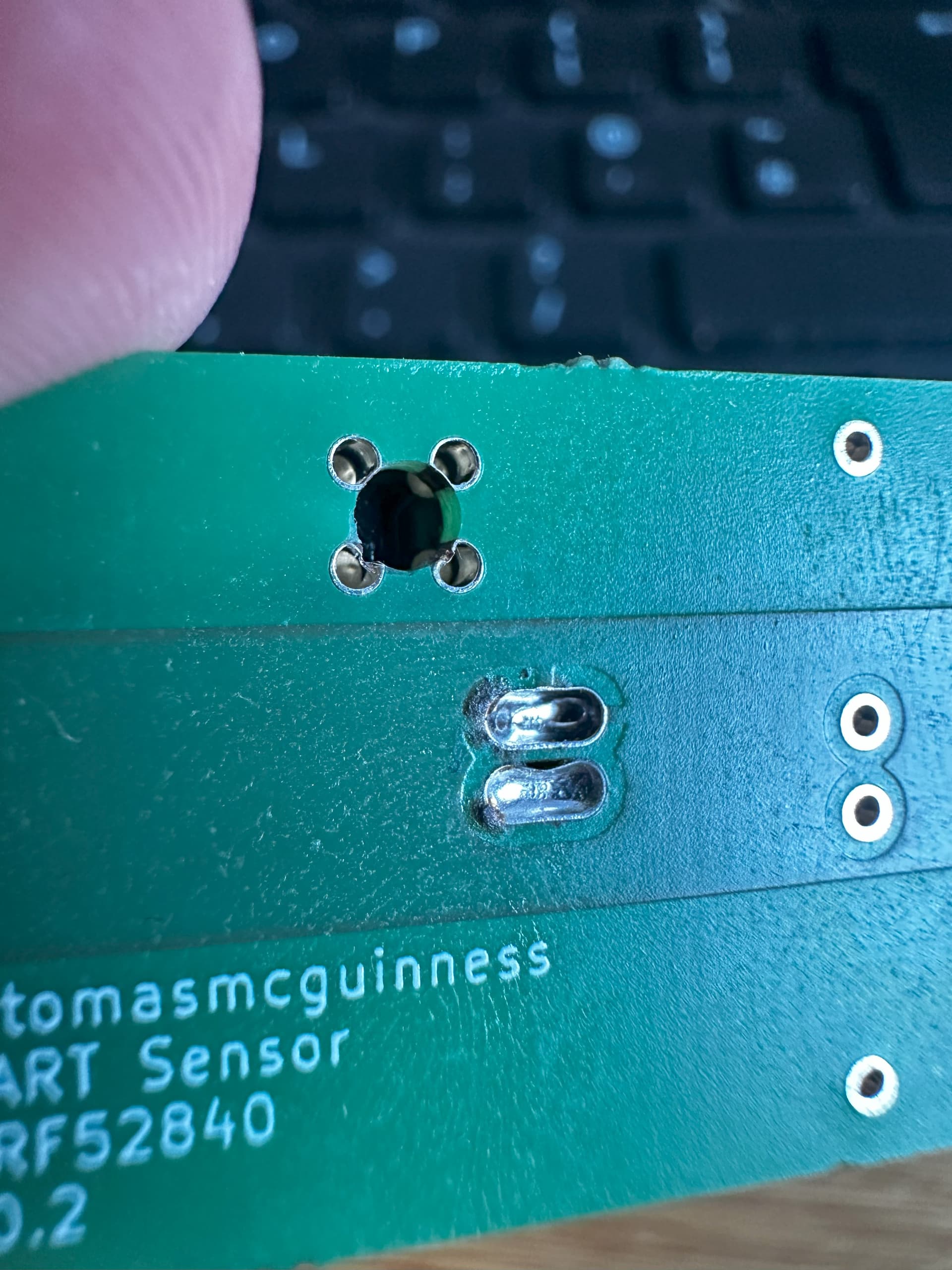

Are you using a really fine soldering tip or using solder paste?
I think, are you state, my ovals are too big (nor fully aligned either), but I feel this should work. However, it’s almost never does.
I’m wondering if a finer soldering iron would help me make the connection with a small blob of solder.
Also wondering if I could apply some solder paste and put it on my mini hot plate.
Thoughts appreciated!
Yes , Solder paste is the way to go. Looks pretty good a TAD on the big side… but it should work. I use the tiny tip to touch the pad from the bottom of the hole. then add roll solder but I paste and flux EVERYTHING a LOT first :grin: It works 100%
Stay at it you’ll get there. Looks GOOD! :+1:
