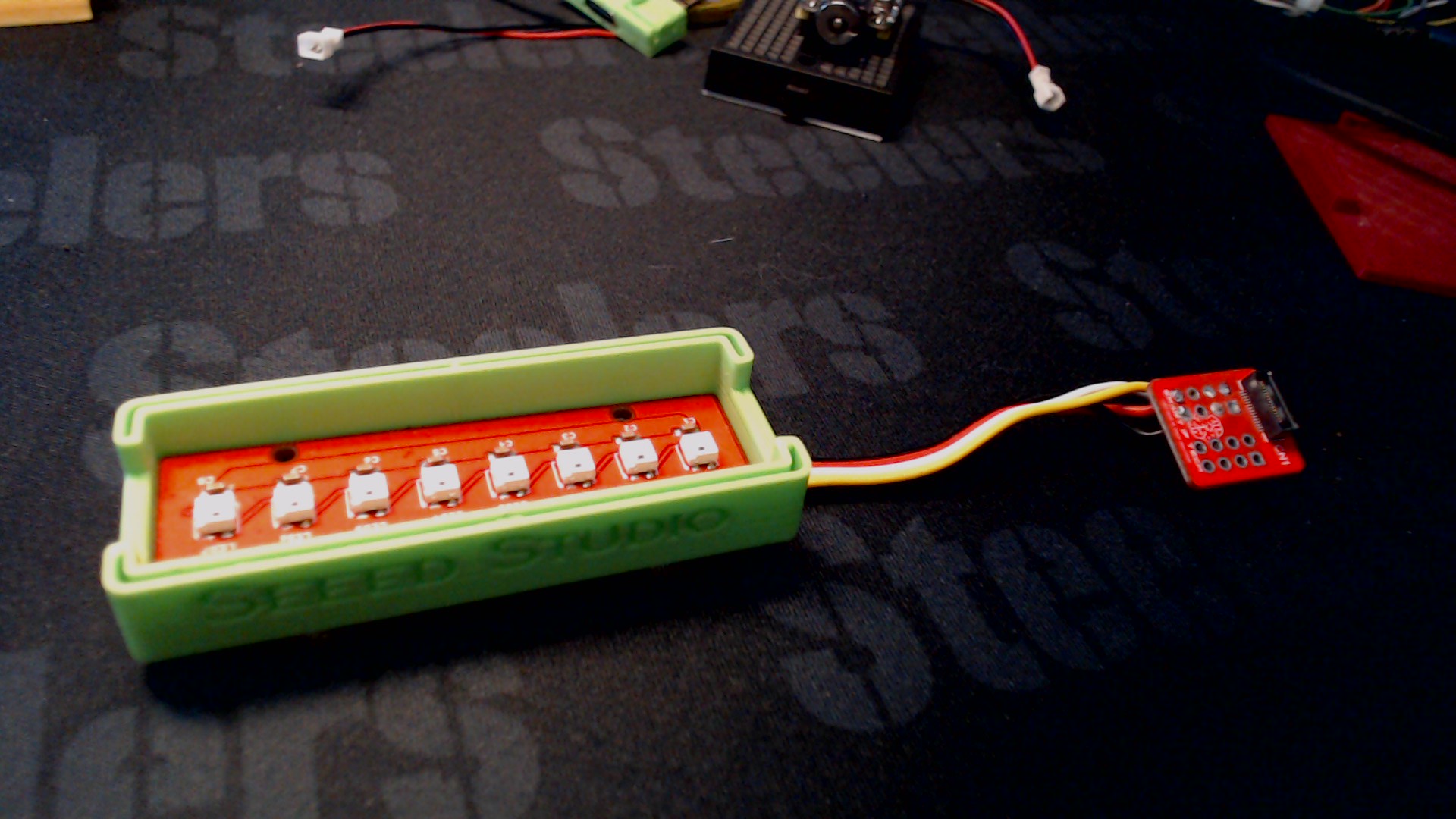

Welcome,
i dont think a ribbon cable is in the plans… the B2B connector is too small you can design yourself a daughter board… I am not sure what space control you are under but this is about the best you can get
So, it should be fine for a short cable but beware!

You can probably order a custom ribbon cable, but AFAIK nothing like it exists on seeeds website.
Check out the MORE I/O thread for the PCB I made for it.
