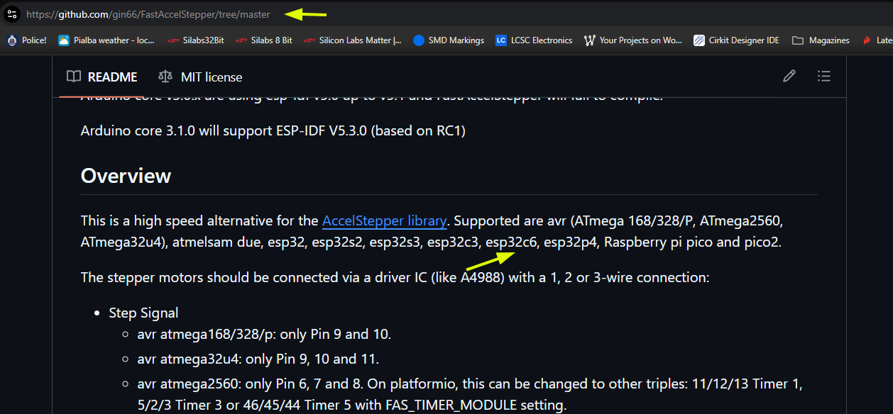

I don’t see where that’s mentioned. I do see the C6 is supported however?

While the ESP32C6 is listed as being supported, in my (albeit very limited) experience it doesn’t (fully) work and is also listed as untested. I can’t prove a negative, but the S3 I have on order is scheduled to arrive on Tuesday and I’ll test it and see what happens. I’ll report back. Obviously if there are still problems then I think we can conclude the issues lie elsewhere, not unlikely between my ears.
