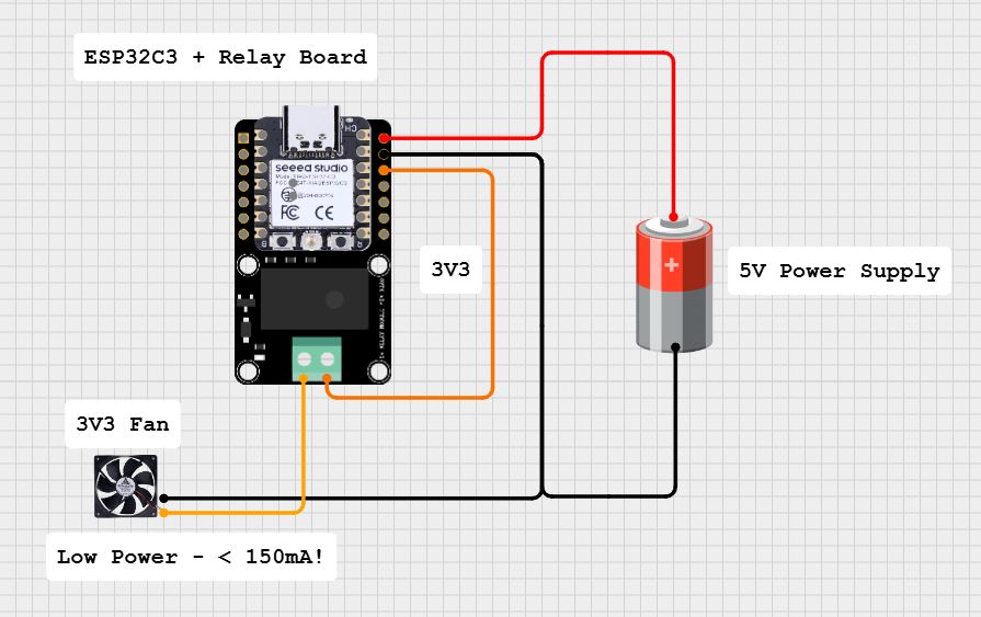

This is a possible circuit and code for a relay driver on an ESP32-C3. See the link for the code.
