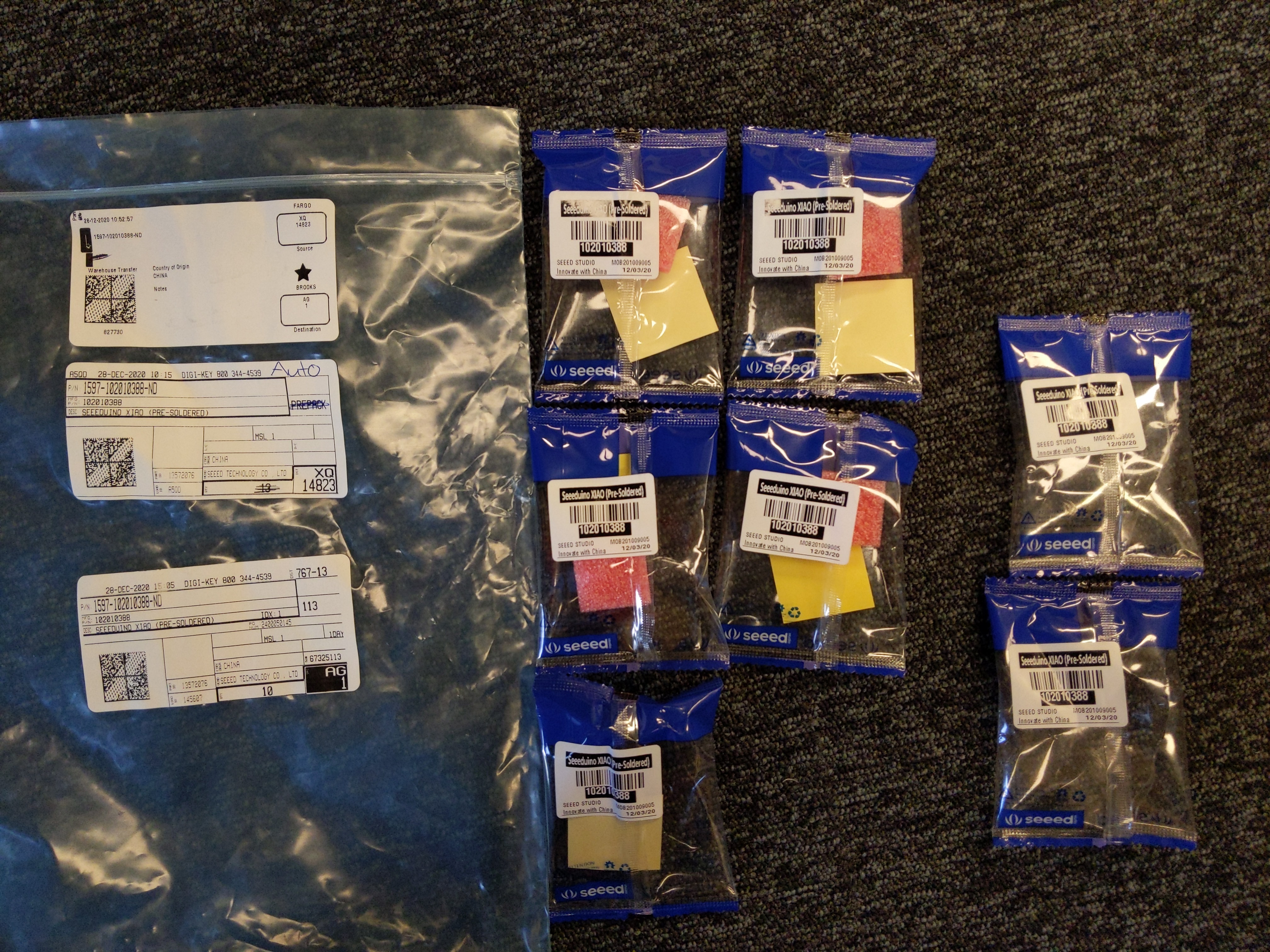

Edit:
Adding a photo of the Digikey packaging and individual packaging with batch and other info in case it is useful.
