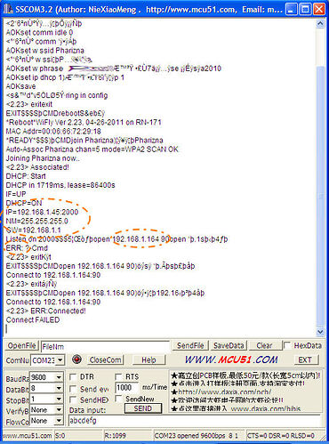

Hi,
I’m using a WiFi shield with Arduino Uno (but I also tested it with a Olimexino board).
I’m using the default TCP sketch.
If I check the communication with the WiFly module I can see a lot of dirty characters.
At the end of the init procedure a TCP channel is opened and it works, but I’d like to understand why I have all this trash in the communication.
Here an example of what I obtain:

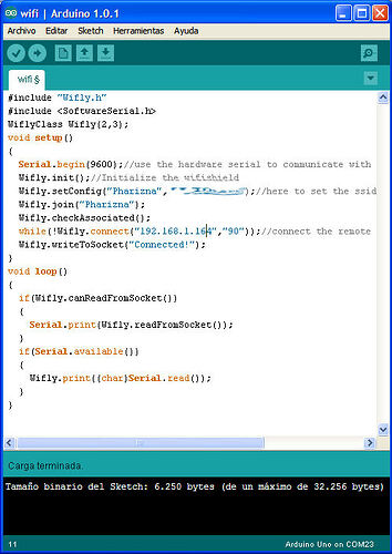

Same problem for me (working with Arduino Uno, too)… but I can’t connect to the “virtual remote server” :neutral_face:
It’s very strange but I’m connected to my local network as you can see
I’m using WiFly Ver 2.23 … and also made another trial opening my wireless network but it doesn’t work neither :cry:
Thank you for your help :wink:

Everyone has their own IP address,so you need compile it like this" while(!Wifly.connect(“your own IP address”,“90”))" :wink:

What’s my OWN IP ADDRESS? Anyone in my domain? Router one? PC that I’m using? :confused:
I tried with my PC one… with my router one… and with my Arduino one too (192.168.1.45) … but always with the same error :frowning:

I’m using DHCP … and the Arduino IP is created by my router… in this case, I previously explained, it’s 192.168.1.45
The problem is there is not CONNECTION to port 90 of this IP :smiling_imp:
Solved!
The remote server IP … it’s my PC IP :astonished:
