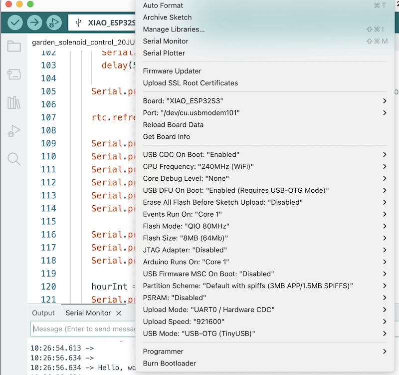

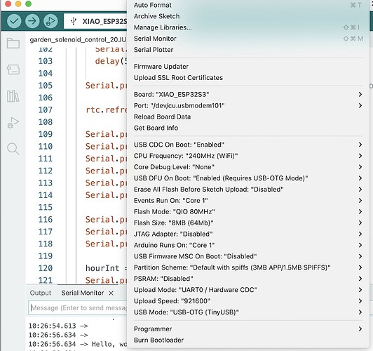

I wanted to begin a thread noting that
1 - simple 15 code line sketch which blinks the built-in LED and prints a simple text message works as coded;
2 - a larger 100-line sketch (with RTC code) will not print to the serial monitor.
Here is a grab of the Tools pull-down:

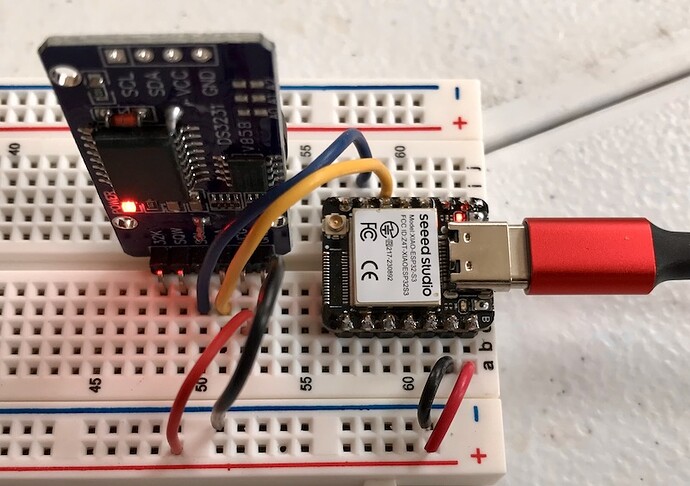

I have no idea why one sketch will print to the serial monitor while the other larger sketch will not. For the sake of clarity, the hardware connected to the S3 was the same for both sketches as shown next:
Thanks for any help you can provide.

Which BSP are you using to compile with , can you post up the compiler output first 3 lines, and the last 20 before the upload?(verbose mode) Use the code tags above “</>” paste it in there. use that for code as well. You are close just something misconfigured somewhere, stay on it… :grin:

The first three lines are as follows:
FQBN: esp32:esp32:XIAO_ESP32S3:USBMode=default,DFUOnBoot=dfu,UploadMode=cdc
Using board 'XIAO_ESP32S3' from platform in folder: /Users/phillipanthonybriles/Library/Arduino15/packages/esp32/hardware/esp32/3.2.0
Using core 'esp32' from platform in folder: /Users/phillipanthonybriles/Library/Arduino15/packages/esp32/hardware/esp32/3.2.0
