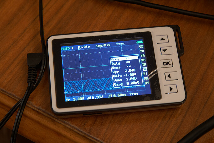

DSO nano v.2 firmware 3.33 BenF, 300Hz sine measured but Vrms not displayed “xx”. Why?

And try again,but in our view, your signals have a problem.Your signal looks a mess, Vrms is calculated according to the normal signal.
Long exposure time makes sine blurred. After update to 3.62 no change, Vrms is not shown.
You need a valid trigger before AC measurements can be calculated. Lower your trigger level to somewhere between Vpp min/max and Vrms will show up.
