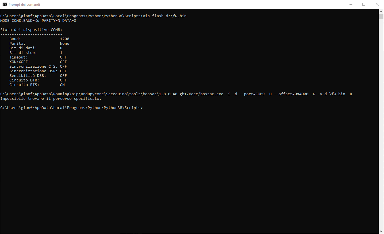

Hi @ansonhe97, I’m trying to use aip as you told me, but despite having correctly placed the fw.bin file in the root of d: I always get an answer “Could not find the specified path”. Why?
Can you give me a suggestion?
Thank you
C:\Users\gianf\AppData\Local\Programs\Python\Python38\Scripts>aip flash d:\fw.bin
MODE COM19:BAUD=%d PARITY=N DATA=8

C:\Users\gianf\AppData\Roaming\aip\ardupycore\Seeeduino\tools\bossac\1.8.0-48-gb176eee/bossac.exe -i -d --port=COM19 -U --offset=0x4000 -w -v d:\fw.bin -R
Impossibile trovare il percorso specificato.

Can you show me a screenshot of the terminal please, hard to tell from text here. Thanks
Hi, @ansonhe97
I captured your terminal but unfortunately it is in Italian I hope you can translate it with the help of google ![]()
Hi @Gianfry60
The reason for this it’s the path is not correctly used, you can do the following:
Type
aip flashin the terminal -
Then drag the bin file to the terminal, this will do the correct path for you.
Excuse me @ansonhe97 but I am not very experienced in python, for terminal you mean the terminal after I launched Python or the Windows Prompt? I am using windows and not Mac. I tried to drag the file to the windows prompt but it didn’t work it gives me the same error
You can use window’s powershell and has all the same command. Under powershell, can you simply try typing:
aip
and see if this is working properly?
If so, try the following to upload an ArduPy firmware to Wio Terminal first to make sure that the aip is working properly:
