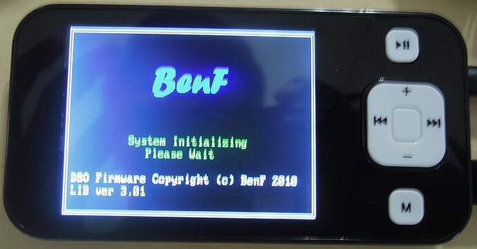

Hi all,
I ma new to this, and have started to upgrade the DSO Nano firmware.
I have successfully copied the specified images into SD Card, but after reboot my DSO Nano gives the screen as attached in the image.
Please let me know how to make it work again.
Regards,
Lalit Shah

Hi all,
The initial screen when i apply for upgrade is as per below.
Here i am not able to connect the device in DFU mode, i just need to copy bin or hex file into the SD card.
The attached image will provide you the screen when i copied the files into the device.
Regards,
Lalit Shah

hi all,
I have update the lib version to 3.13 and it successfully shows the same.
I am applying the app for the same version but not able to see the application version.
The same files works fine with the DFU mode upgrade process.
How to configure this device to work in dfu mode?
Regards,
Lalit Shah
