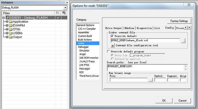

I am using IAR v 4.42A to compile the APP code, but after all the files are compiled I get this error (see bellow). Does anyone know why this happens?
Thank you.
Check your link configuration:
Thank you for the advice !!! It worked !!!
