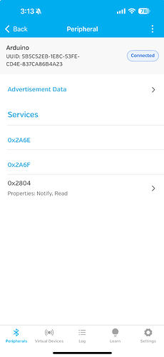

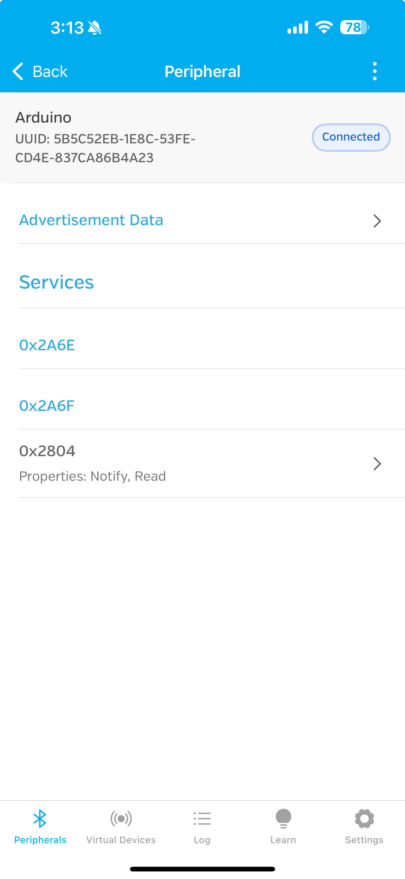

Hello friends,
Apologies if this issue has been already answered. I am trying to test a sketch to display the Temperature and Humidity values using the Lightblue App in IOS and it seems whatever I do the temperature characteristic is not showing. Humidity is coming up with exactly identical code. I am using the nrf52840 BLE Sense Module. Any help will be greatly appreciated !

try that, you have the Characteristics and services incorrectly setup.
BLEService temperatureService("2A6E");  // 2A6E is a *characteristic*, not a *service*
BLEService humService("2A6F");          // Same issue
Both of those lines are trying to define BLE Services using standard 16-bit Characteristic UUIDs, which is invalid.
The temperature and humidity UUIDs (2A6E, 2A6F) are characteristic UUIDs, not service UUIDs. They’re supposed to be used inside a service — not as services themselves.
I have some demo’s on here of this exact setup, hit the search “BLE Environmental” you’ll see it. :+1:
@PJ_Glasso Thank you soo much for your help with the code and clarification ! It works !!
