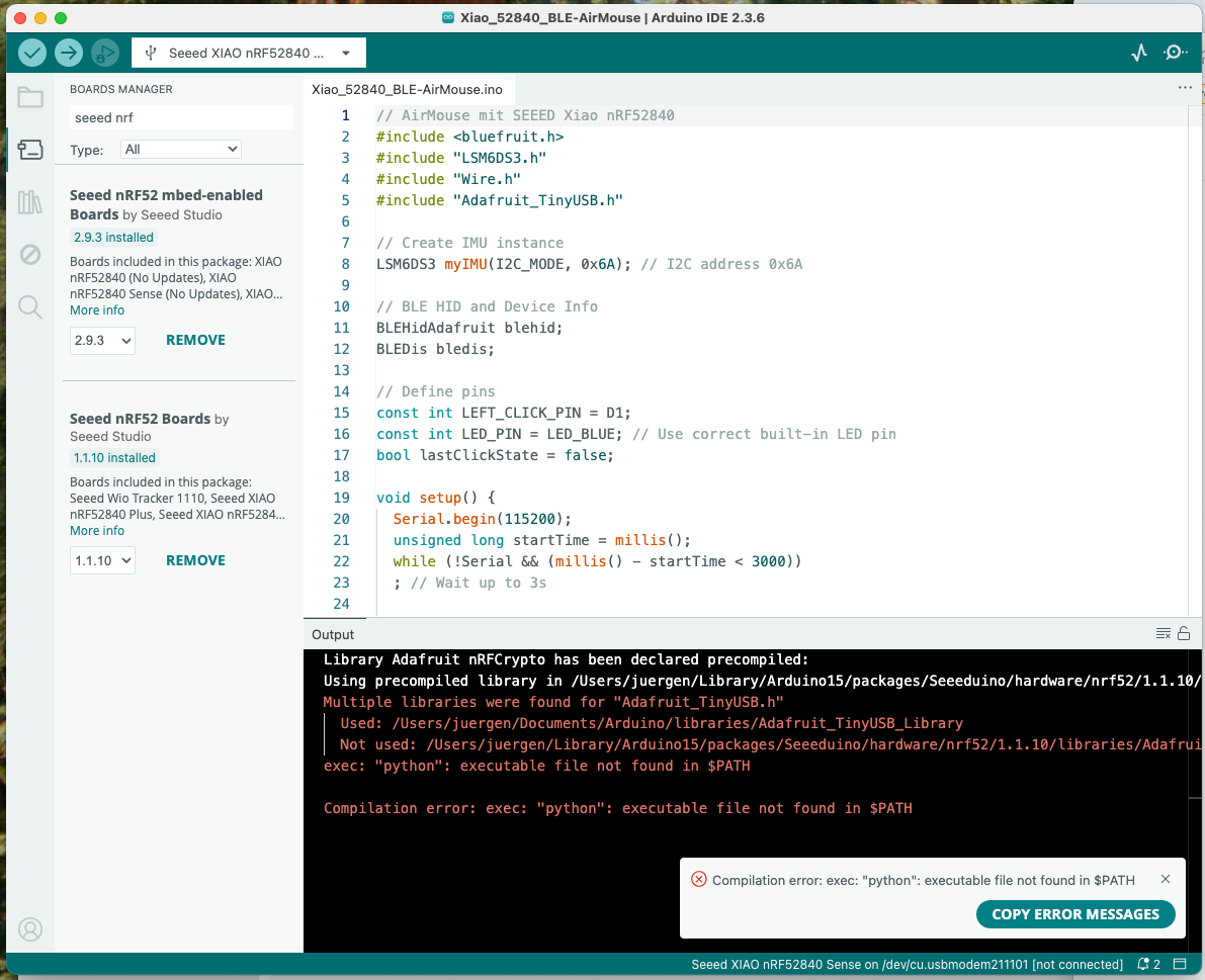

After compiling the BLINK example with Arduino 2.3.6 for my XIAON nRF52840 Sense with Board Manager 1.1.10 i get this error:
exec: “python”: executable file not found in $PATH
Compilation error: exec: “python”: executable file not found in $PATH

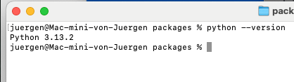

Hello,
the python version is in the path, but this does not help.

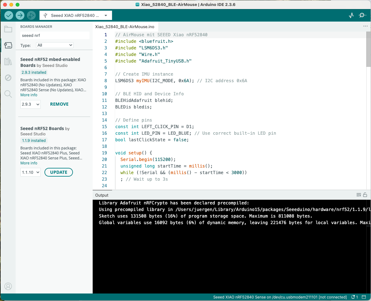

@Seeed_John:
1.1.10
1.1.9

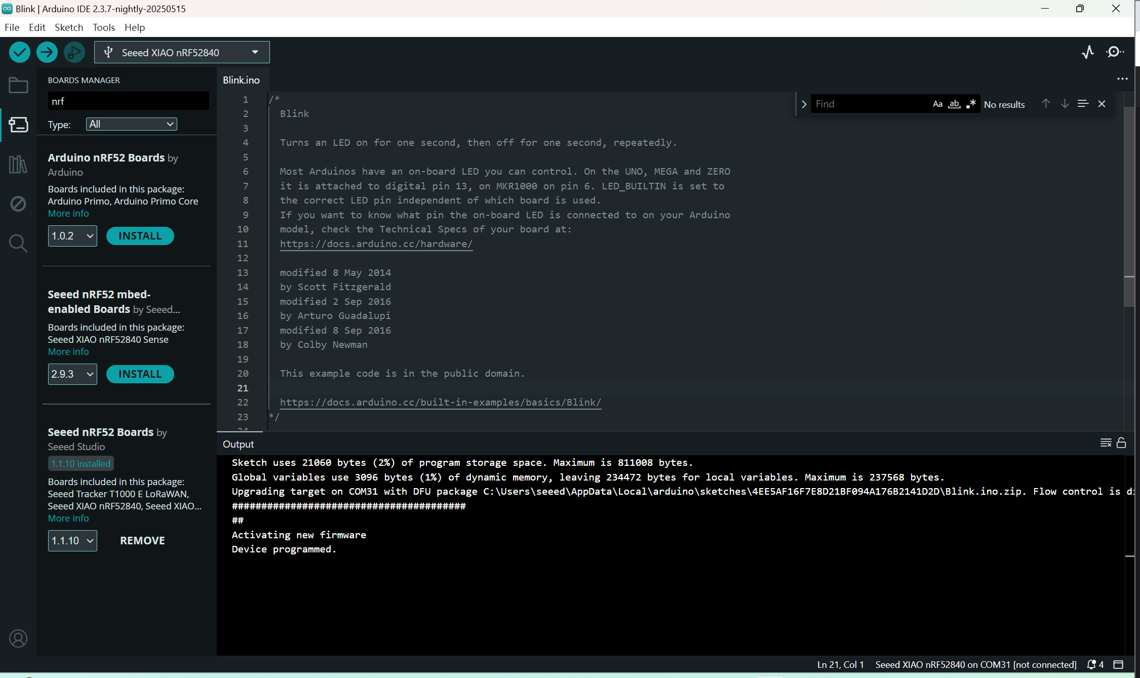

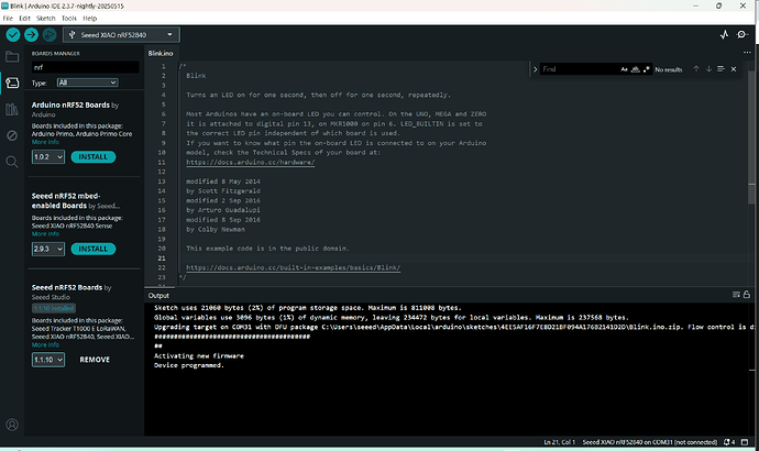

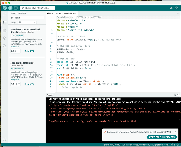

This Error appears on my Windows 11 PC too:
(BM 1.1.10):
(BM 1.1.9) it works!

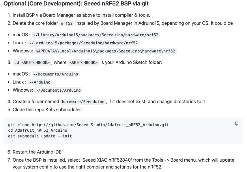

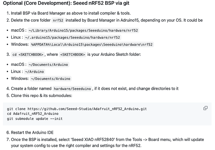

That’s interesting :slightly_smiling_face: I am assuming you download the Seeed nRF library from Arduino IDE directly. Maybe you could try uninstall all seeed nRF libraries in Arduino IDE, then download the seeed nRF52 board library directly from github.
Go to the github page: GitHub - maxgerhardt/framework-arduinoadafruitnrf52-seeed: PIO repackage of the Seeed "1.0.0" core (Adafruit nRF52 core fork)
And follow the instruction how to download the repository directly from git.
Regards,
John

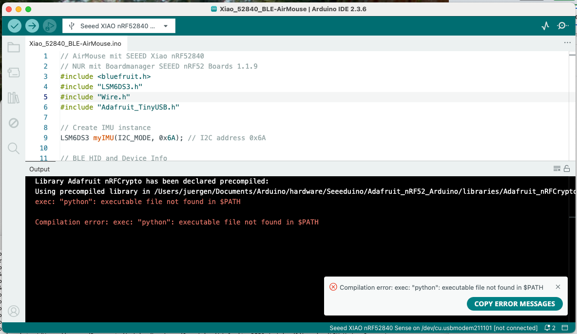

I followed exactly this on my MAC:
Result: :frowning:

TL;DR:
  • Edit the platform.txt file to replace ‘python’ with ‘python3’
Details:
The clean install version of python on the Mac is python 3.9.6. I’m running Sequoia 15.5 on an M4 chip. The default for the OS install of python is ‘/usr/bin/python3’.
Version 1.1.10 references python when creating a uf2 file. Changing that reference to ‘python3’ allows the system to compile.
Aliasing the python3 in the .zshrc file didn’t seem to work, and I couldn’t create a link in the /usr/bin/ folder. I’m not fully satisfied with the fix, but here are the steps.
  • edit ~/Library/Arduino15/packages/Seeeduino/hardware/nrf52/1.1.10/platform.txt
  • change ‘=python’ to ‘=python3’ (Line 113 and 112 even though it’s commented out)
