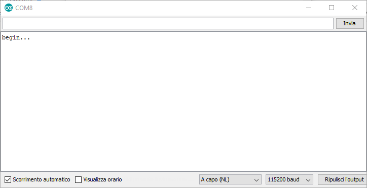

Hi @ salman, I tested your code but the result is the same as you can see from the photo of the Serial Monitor the program stops if I disconnect the positive pole from the sensor
