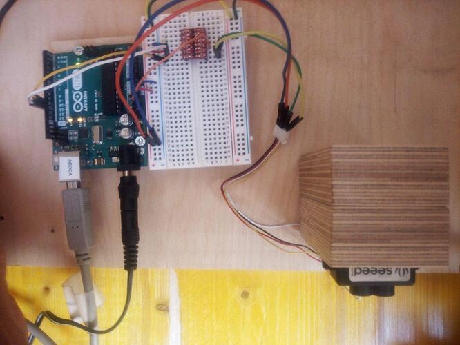

Below a short description of my circuit (photo below):
[attachment=1]photo_2020-01-22_14-33-10.jpg[/attachment]
- Arduino GND attached to: Logic Level Converter GND and TFmini Lidar GND;
- Arduino 5V attached to: Logic Level Converter HI input, TFmini Lidar VCC;
- Arduino 3V3 attached to: Logic Level Converter LO input;
- Arduino pin 10 (RX) attached to: Logic Level Convert CH1 input;
- Logic Level Converter CH1 output connected to: TFmini Lidar TX;
- Arduino pin 11 (TX) attached to: Logic Level Convert CH2 input;
- Logic Level Converter CH2 output connected to: TFmini Lidar RX
