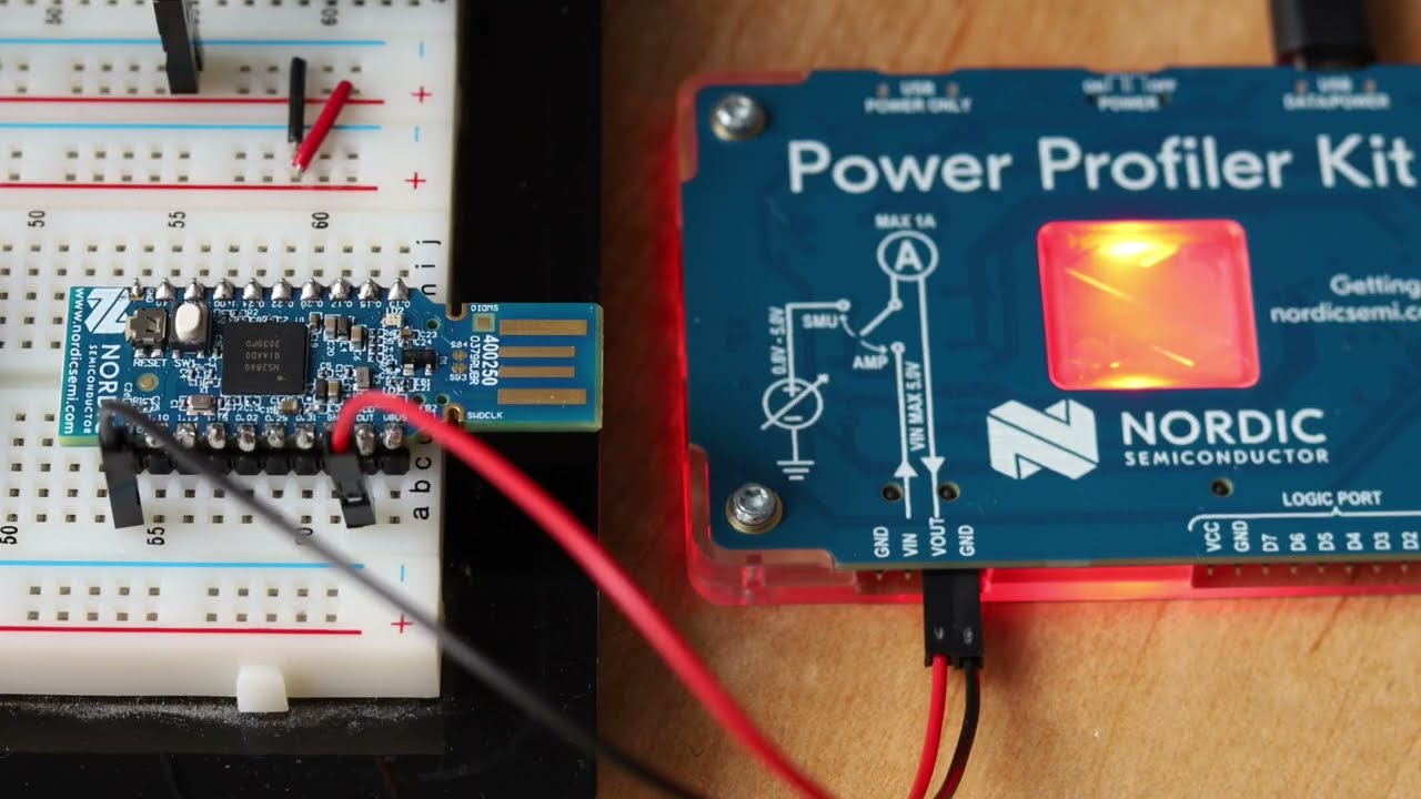

So who knew, The Interrupt method also effect the sleep, If you use an edge (RISING/FALLING)it uses more current during sleep to maintain the trigger gate, If you use a level (LOW) it uses less current in sleep?? mode.
Here is an Old video demo with a PPK as well worth the View.
