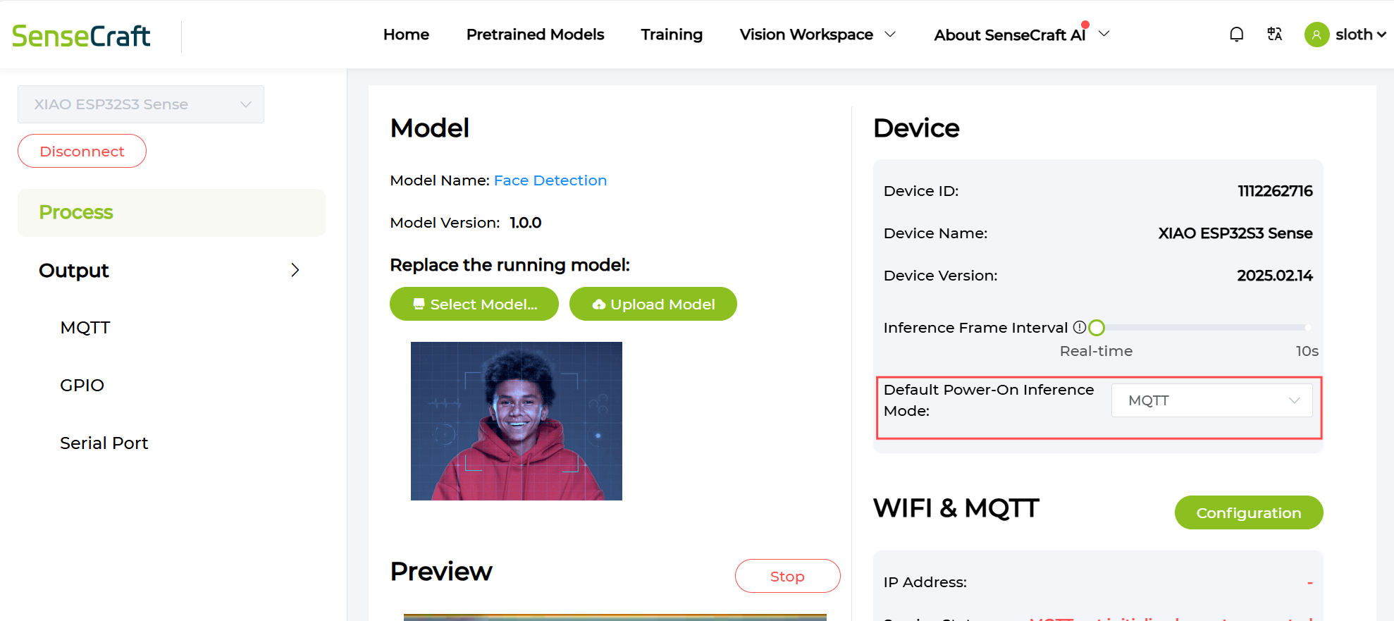

You need to set this to MQTT, so that the model inference can be carried out with only power supply when not relying on sensecraft AI.
