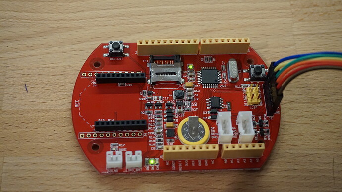

Hello,
I’m new here and I have a similar problem.
The Stalker v3 connect to PC using UartSbee v5.
I also use 165 IDE.
Setup of IDE is Arduino Pro or Pro Mini ATmega328 (3.3v, 8Mhz).
But a sketch is not loaded into the Stalker.
Sketch uses 450 bytes (1%) of program storage space. Maximum is 30,720 bytes.
Global variables use 9 bytes (0%) of dynamic memory, leaving 2,039 bytes for local variables. Maximum is 2,048 bytes.

Hello,
Please check the following
1.UartSBee is set to use 5V for target board
2.The pin connections follows seeedstudio.com/wiki/Seeedui … ng_Started instruction.

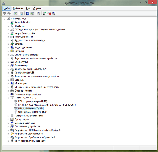

3.Make sure correct COM port(UartSBee) is selected in Arduino IDE
Also post a picture of your setup. Thanks for writing to us.
Hello viswa! Thanks for your answer.
I did as you wrote - UartSBee switch into 5V position, Arduino IDE 1.65 - Pro or Pro Mini (3.3v , 8 MHz)w/ATmega328, the pin connection like as on the instruction (RX-TX, TX-RX). In the attachment some photo, screenshots and video. Sorry, screenshots with Russian fonts :blush:

sorry for panic, it was my mistake, I had stayed the night … :unamused:
I am still confused RX / TX.
everything is ok!
thanks

Yes, everything works fine now!
Thanks.
