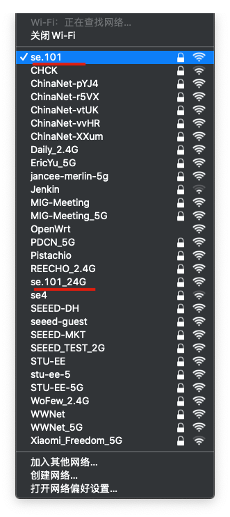

You can first see what channels the old (atWiFI) Wio Terminal connected in your WiFi. Then in the new (rpcWiFi) Wio Terminal connect to the wifi with specific channel like this:

Sorry for misunderstanding.
So your rpcWifi Wio Terminal does not connect to the 2.4GHz SSID? Do you mean in your set-up, both wifi have different names like this:
Hi. Yes that seems to be the issue.
I have TWO SSID’s. The actual names are ‘George’, this is the 2.4Ghz and ‘Mildred’ is the 5.0Ghz. These are specific names I gave them when I configure my router.
They both use WPA2-PSK. Mildred is fixed to Channel 44 and George is set the Auto so will vary.
I have been using George up until now as the signal strength is better where I have the WIO Terminal positioned.
However now it does not list George. The Laptop sitting next the the WIO Terminal lists and connects to Both George and Mildred.
Hi.
I have just tried the upgraded version again and I can now see both 2.4 and 5.0 bands. It seems to be intermittent. Somtimes I can see both and somtimes only the 5.0 band.
I will try updating the firmware again and download the latest libraries to see if there was some corruption or failure to install.
Regards
Stuart
Okay this seems strange, as in our case we can connect to 2.4GHz Wifi very easy and this is the main bandwidth we used for testing.
