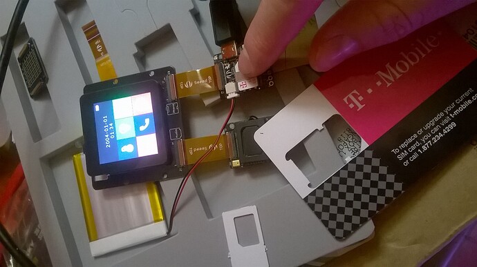

Here is a quick vine of my RePhone receiving a call just in case anybody wanted some proof:
vine.co/v/ii3wA5qutj5
I also added a photo of the sim card I got from T Mobile
