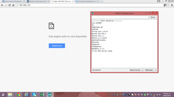

I’m able to compile and even the web server gets ready (see attached) but when I try to visit the IP address in a web browser the page is not loaded (see attached)

I notice that wifly.available() always gets 0 because the LED never turns on. What can I do? Some idea? Thank you.

I have got a message : please make sure your AP isolation option is turned off in your router. Please have a try.
SOLVED!!!
I made the following changes and it works!!!
