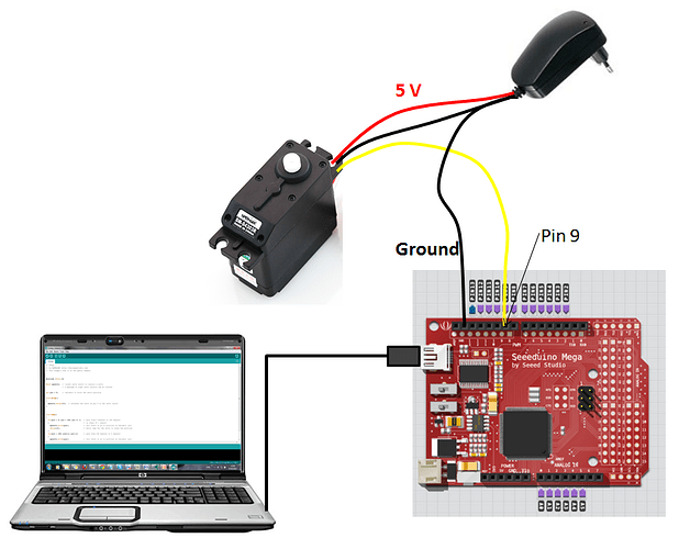

You can see the connection on the attached document.

The problem is that the servo turns continually and do not execute the routine. There is a problem in my connection? Why it does not work properly?
Thank you.
You chose a 360° servo which is controlled differently than a standard servo (0-180°). Reading the specification you might use the Servo.h library but you have to specify the microseconds explicitly and choose them according to the spec sheet (1500us is middle position, above that the servo turns clockwise, below the servo turn counterclockwise.
If you wanna just do what’s in your code, buy a standard servo, you’ll have more fun with it.
