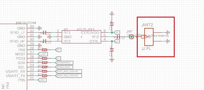

Does the external uFL antenna port work for 915 MHz and if so is there something that must be done to enable the uFL port? I removed the wire antenna and connected an antenna to the uFL port and there was no signal.whatsapp web 192.168.0.1 routerlogin

Hi,
In the schematic, we don’t need to enable anything to use u.FL external antenna, make sure you are connecting the correct way.
[attachment=0]Capture.JPG[/attachment]
