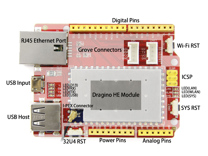

1. Please press the wifi rst button more than 30 seconds with power supply.
2. Wait for around 1~2 mins.
3. you can see the ap as below.
thanks

1. Please press and hold the wifi reset button more than 30 seconds
2. Please wait for more time, you can turn off the PC wifi and then turn on it again. It will take some time to see the AP back.
3. Please try several times.
4. If it does not work, you can try to download the firmware. you have to connect to network cable and use the ssh to remote control it. NOT through the serial. the firmware is at resources session of wiki.
