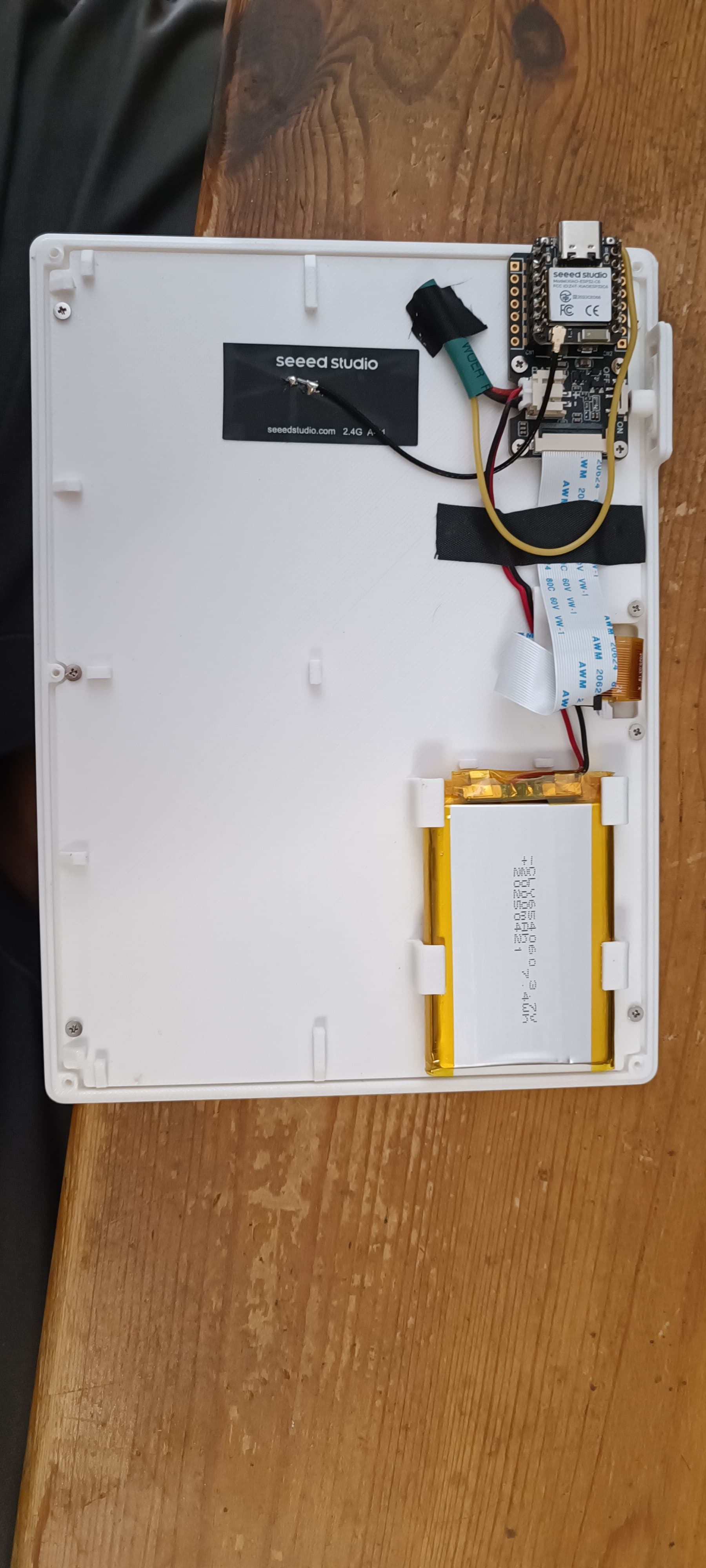

Hi There
Based on msfujino’s work], I tried to measure the battery, but unfortunately, there are no more ADC ports available for the C3.
So I looked for another compatible xiao and I found the C6.

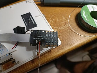

I soldered the resistors directly onto the battery terminals under the driver board.

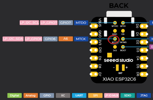

Then I soldered a cable to GPIO6 on the back of the C6 (I forgot to take a photo).
Finally, I put everything back in its place and reconnected the resistors.
I had to modify the code a little bit to make it work with the C6, but now it’s perfect.
I’m currently running tests to calibrate the battery, but with deep sleep mode it takes a long time.
For the code i use esphome (not optimized)
