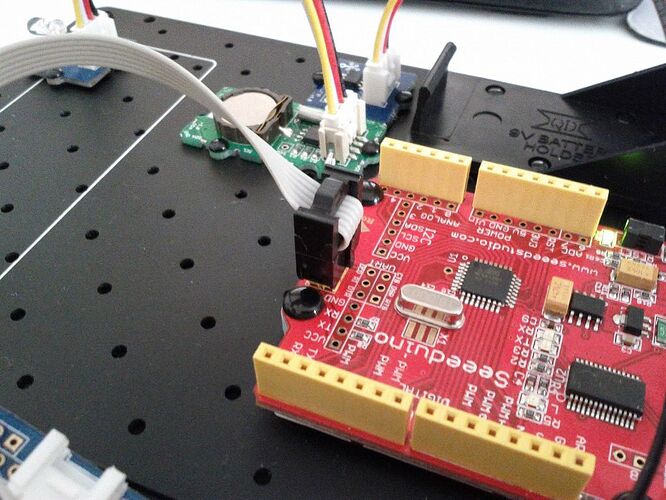

ISP Connected right? (see picture)
If this is ok i think the atmega is dead (wrong fuses burned/short circuit on a digital pin/…) or its a hardware problem (cold solder joint).
From what I can tell the ISP is connected correctly.
Visually I did not see any cold soldering joint (but that is not a real test).
So I guess this is a dead board.
