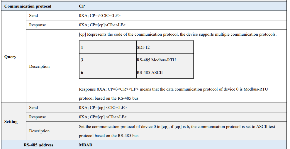

You can connect a USB-to-Type-C cable and use a serial communication tool to enter commands to verify whether the S1000’s mode matches the configuration in the SenseCraft app on the S2100.
