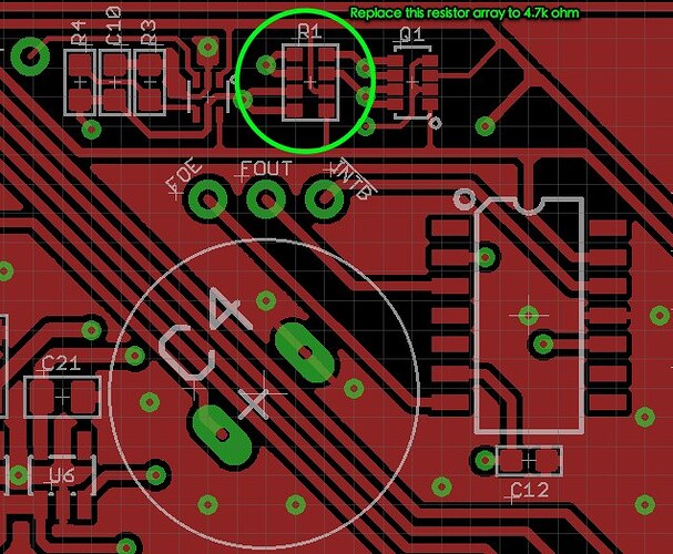

As a solution I saw that a 4.7K resistor can be placed, but I didn’t catch where exactly I have to place it. Can someone post a picture or a schema explaining this?

Stalker 2.0 uses RX8025. The DS3231 is used from 2.1.
But the problem is actually with RX8025
Please replace the R1(in green circle) resistor to 4.7k ohm.
