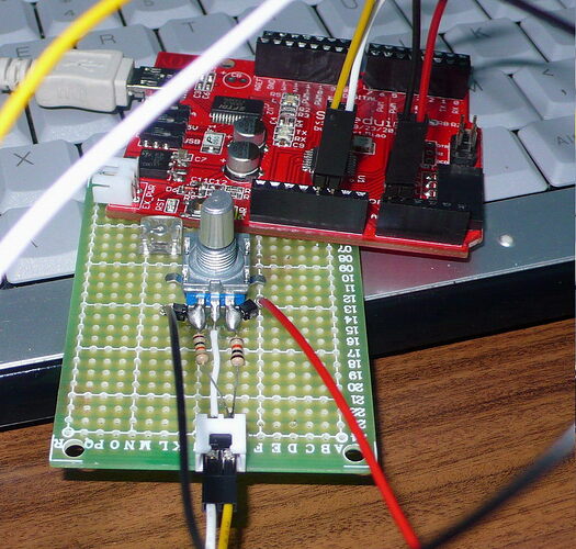

Hi guys,
Here is the wiring demo:
White wire connect to GND;
Yellow wire connect to +5v;
Black & Red wire connect to I/O pin;
Arduino usage: arduino.cc/playground/Main/RotaryEncoders
Hi guys,
ps. the resistors are 10k. Thanks
