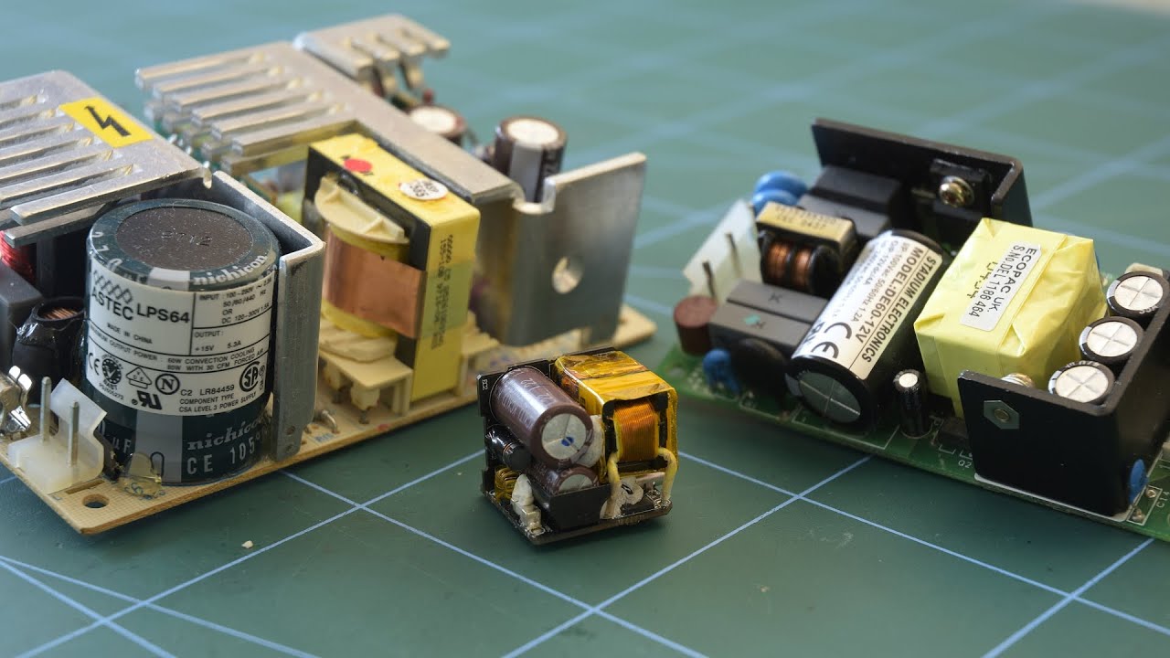

is it a switching power supply it’s plugged into (RPi), swap it out.

switch mode power supply is my vote!

Thank you so much y’all. The power strip where I keep my TV and speakers had usb charging outlets and that is what I was using. I plugged it in the wall directly and with a power supply made for raspberry pis and the noise stopped.

Those outlets are Isolated, so the grounds have a filter on them the ticking was the RC time constant of the circuit It “resonates” at a frequency that is factor of the high impedance and a ground path.
to check unplug it from the system , test the grounds for continuity between. either very LOW or open completely. :+1: is what you’ll find.
