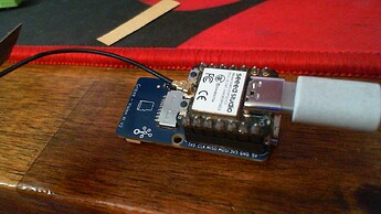

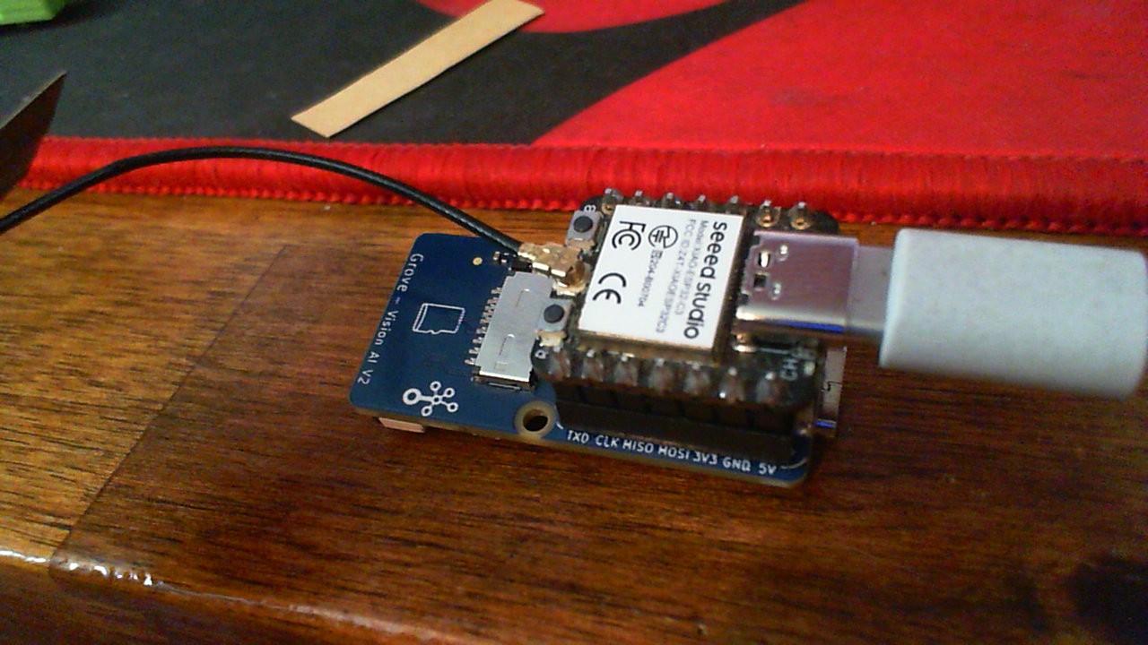

and NOW after the return to factory bootloader… here is what worked.
So mount up a C3 is what I used, but an S3 will work also.
Disconnect the camera.
make sure you have the latest version of the "seeed Arduino SSCMA " 1.03 library installed,
It wouldn’t run with the current BSP either , go figure :face_with_hand_over_mouth: , I had a hunch it wouldn’t. I used 3.1.0
Thanks Espressif :fu:
So load up the sketch from the examples >Seeed Arduino SCCMA “we2_iic_bootloader”
set the pins for the I2C for the MCU
// Please check the I2C pins of your board, -1 for default I2C pins
#define I2C_SDA_PIN D4
#define I2C_SCL_PIN D5
they -1 didn’t work for me, I set them to be sure… :+1:
I put the C3 in Bootloader mode, and hit Upload

now the fun it’s a equivalent to the "Secret handshake " because I couldn’t find it listed anywhere…
Hold the reset button on the GVAI2 and tap the reset of the C3 (mycase)
you get this and it finds the I2C address of the GVAI2
Grove Vision AI (WE2) I2C Bootloader Recovery Tool
Built on Jul  5 2025 21:35:40
Probing Grove Vision AI (WE2) on I2C bus...
Cannot detect target device, please check the I2C wire or power supply
(I let go of the reset)
Detected target device
Press 'enter' to start recover the bootloader (or 'q' to restart)
Recovering WE2 bootloader...
But wait there’s MORE :grin:
I get some Error after pressing enter and it does absoulutly nothing…
the fails with a PPStat -1 error. Back to the beginning.
Progress: [                                                                ] - 0.00%
nope stays there …for ever
But then … press the Boot button and the whole thing does a dance across the screen… C’mon man. :face_with_hand_over_mouth:

Done, the bootloader has been recovered successfully!
message,and Now on Senecraft…I get what you have a blank Device screen , VERIFYING THE ISSUE :grin:
STAY TUNED , I’m gonna see if the firmware file in the bl; fix is current I bet it’s not , wouldn’t surprise me if that is what is nedded. Hang tight,
I had 3 as it turns out I won one on the first or second LIVE stream.:+1:
new one needless to say connects up and populates AOK. :sweat_smile:
