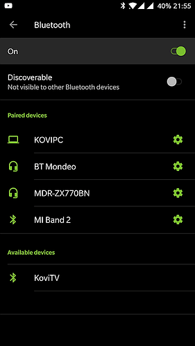

And now the device is not available on my Android:
[attachment=0] 20180517-215514.png[/attachment]

Thank you, connection is OK I can connect to “Respeaker-20C7” device.
Can I use Respeaker as a Bluetooth speaker. I would say, “Respeaker, Bluetooth” or “Respeaker, pair,” to begin pairing? - after the first pairing the Respeaker knows my device and can run the music player on Android and can play music, what I want it.
