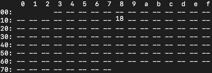

And they are when I run lsmod | grep snd_soc. So I checked if the card is even detected and thats where I am at now and where I am getting stuck. I am starting to think something is wrong with the hardware itself. To check this I have done the following:
Run dmesg | grep -i wm8960 to check if the chip is detected and I got the following messages:
probe with driver wm8960 failed with error -5
Failed to issue reset"
When I run sudo i2cdetect -y 1 I get the following:
Unfortanatly I don’t have a spare Respeaker or Pi lying around for now and trying to postpone buying and extra for now if I can help it :wink: .
I hope someone can help me with this or understand what is happening/confirm things for me. Thank you all in advance.
Greetings Bintley
EDIT: After banging my head on this for a day and posting here I just found out I have the ReSpeaker 2-Mics Pi HAT V2.0 which uses TLV320AIC3104. I am retrying and will update this post if it’s working or if I hit any issues.
