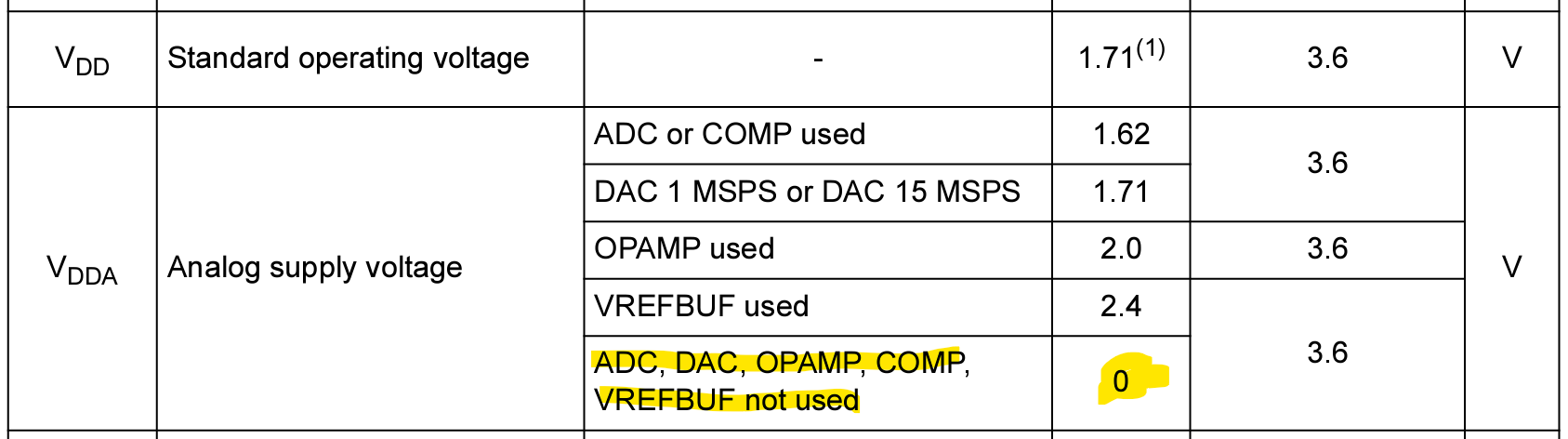

Hi there,
So 3 phase motor control ? is it like this is what you are trying to get to?(green arrow)
A XiaoESPC6 may do the job with a port expander.?
Keeps it super small. Stackable too.
What is you application ?
HTH
GL :slight_smile: PJ
reading?
