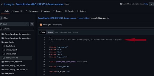

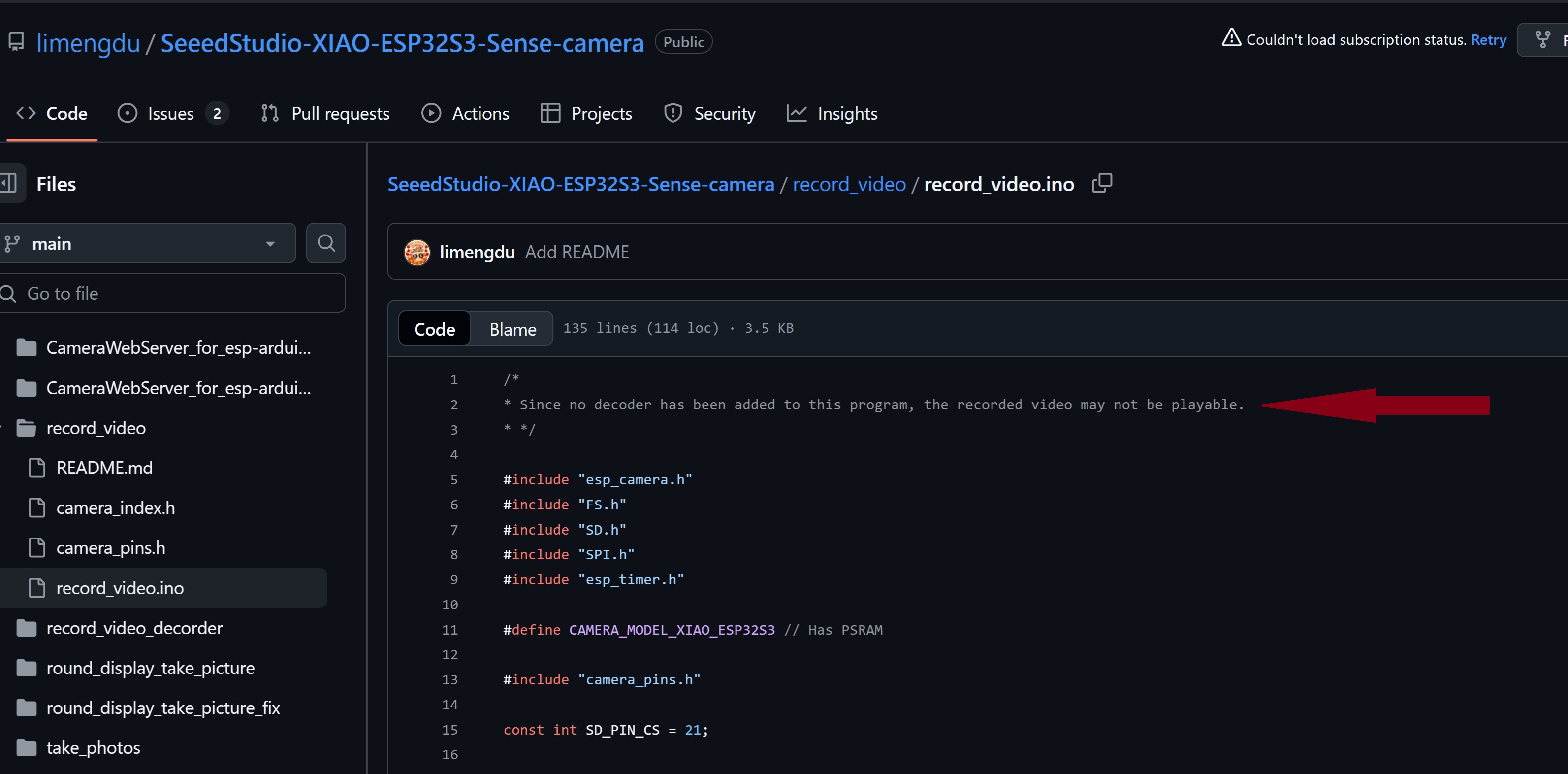

So, I see this doesn’t generate a playback, only writes it to SD.
I would try the Arduino example first, so you understand how it works.
also the board name has to be the “Sense” version.
It works as expected in the Arduino IDE. :+1:
