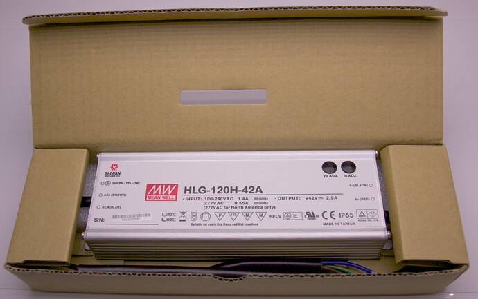

Dear all,
I’d like to control the LED on/off via a grove relay.
The LED power supply is: 277 VAC 0.55A 50/60Hz (input) and +42VDC 2.9A (output).
I see the Grove Relay only can handle +30VDC.
Are there any other Grove Relay can meet the requirements?
Any suggestions?
Cheers,
Michael
ps. please see the attached power supply picture.
The 277VAC in is likely the maximum it can take. Where are you in the world and what power comes out of your wall? It’s very likely the grove relay can switch in the AC side of this since pretty much everywhere is either 110v or 220-240v, and the grove relay can handle both those fine at the current specified
