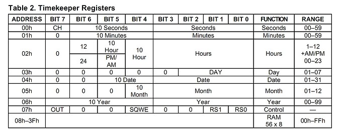

yes, it’s the library problem.
void DS1307::start(void)
// unset the ClockHalt bit to start the rtc
// TODO : preserve existing seconds
rtc_bcd[DS1307_SEC]=0;
save();
when you RTC.set(DS1307_SEC,52); , and you call a RTC.start(); , this functiom will clean the second value. so you can set the RTC.set(DS1307_SEC,52) behind the RTC.start(); then it can work begin with 52 sec.
or you can modify the library to rtc_bcd[DS1307_SEC]&=0x7F;
