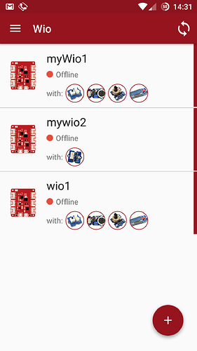

After one Wio Link lost the connection to the server I somehow managed to register a third Wio Link in the Android App to my own Wio Server (Docker installation), although I only own two.
Is it possible to delete the unused Wio Link? Let it be within the App or directly in the server?
Got the answer myself: seems you only can delete a node via the API -> seeed-studio.github.io/Wio_Link/#delete-a-node (worked for me, but IMHO it also should be possible to delete a node with the app)
Hello uwe.fetzer I deleted a Wio on my Android app by swiping the node to the left then selected delete a couple of days ago. I have not tried since to confirm. I am also interested in your docker server . It would be great if you can document that on this forum. I would very much like to do the same.
