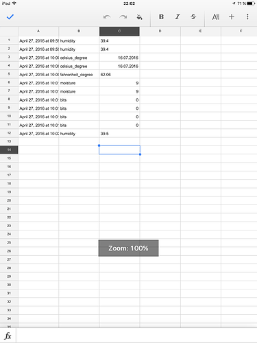

Hi, I just played around with Wiolink posting data into a spreadsheet and if I try to add temperature in degree Celsius it fails.
I can post every other data successfully like you can see in this screenshot above, just degree Celsius gets converted in a date??? How can I solve this problem?
What groves you use?
The “not working” sensor is a humidity and temperature sensor dht22.
I got it working. I had to change the table settings to United States, because in my country we use usually a comma(,) as a decimalpoint(.)
The Google autoformat recognized always a date.
Now it works.
