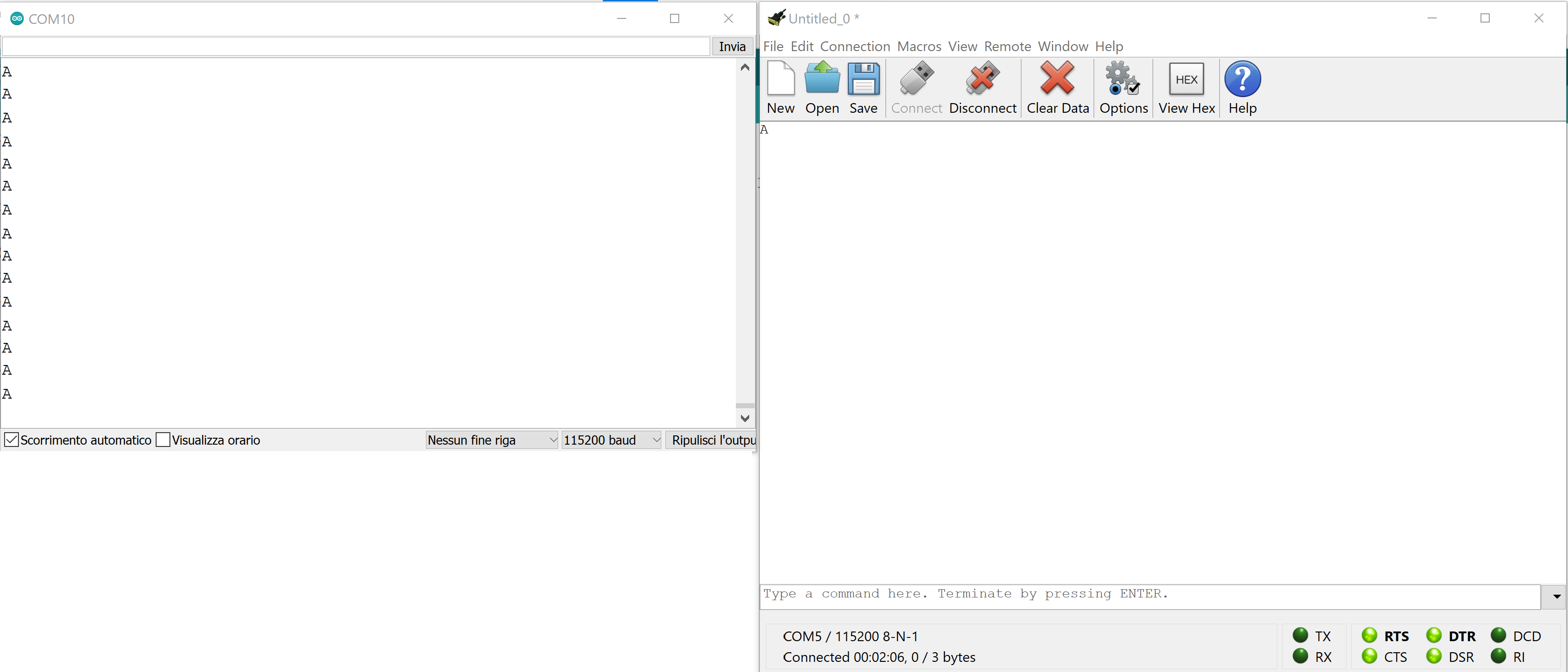

I’m testing the components by sending “A” and “B” by keyboard (through CoolTerm) with the RN42 so that a simple vibromotor connected to the Seeeduino gets activated.

I simply connected the module to 3.3 V, GND, RX and TX of Arduino Uno board, I used the following options on CoolTerm and everthing worked.
I tried to repeat the same procedure on the Seeeduino, but when I type “A” or “B” on CoolTerm nothing happens.
