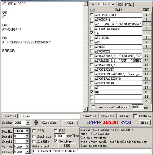

and everything was ok till I tried to type the following command to send the sms on the sscom.3.2:
AT + CMGS = “+393311234567” → ERROR
But it reports ERROR as you can see in attach file.
(you can find in attach a screen shot)
I have also tried to modify the message center, but I’ve an error also with that instruction.
AT+CSCA=“+393916263333” → ERROR
I don’t really know what I can do.

Hi,please have a try to call a native phone
such as AT + CMGS = “Phone num”
and please confirm the protocol of your phone.
“CMGS”、“CSCA” , or others?
