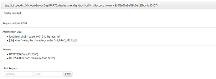

There doesn’t seem to be a Wio Link forum yet so posting in this one. I’m experimenting with the Wio Link and Grove Digital display (the one with 4 digits) There is an example on how to post a digit (using position and character) using restful API as per the screenshot attached. What I wanted to know was how could you post 4 digits in one API POST. E.g. 1234, not just 1.

Please try another API "v1/node/Grove4DigitUART0/display_digits/[start_pos]/[chars]?"
