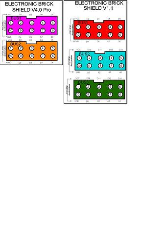

I need the pin idintification on the two 10 pin ribbon connectors on the E.B. V4.0 Pro. Any one know where I can find this information?

Hi all,
I rang out the pin of both Electronic Brick shields V1.1 and V4.0[img]
If you are interested.
