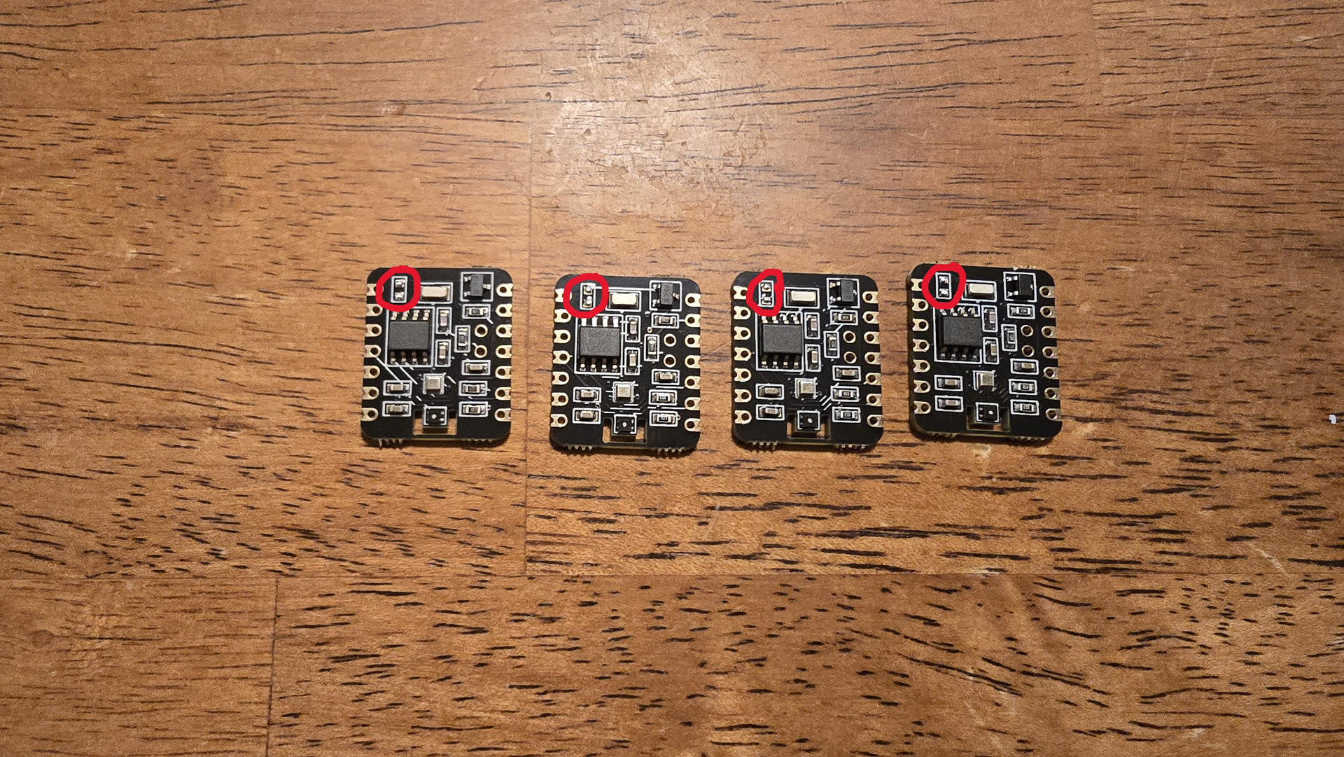

PCBA Defect – Missing Resistor R6 on All Assembled Boards
Order #260422032000 – Missing R6 on all assembled boards
I received a Fusion PCBA order and discovered that resistor R6 is missing from every assembled board.
R6 is present in the BOM and Pick-and-Place files submitted for manufacturing. I have photos, screenshots, and supporting documentation.

Hi Eman, I’m Yuki from the Fusion Support Team. Regarding your inquiry, after our internal review, we found that the BOM file you uploaded did not include R6. I will confirm this with you via email later.
