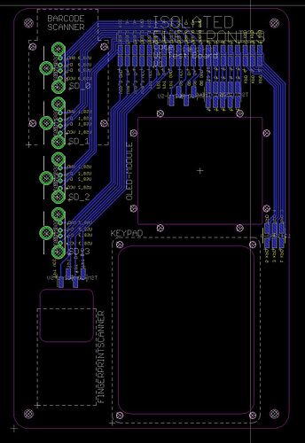

I have a board (95mm x 145mm) with 3 cutout windows as pictured below. Do I leave the cutouts as pictured (in pink, on the dimension layer) or do I set them up as a routing process with Stamp-Hole (mouse-bites) to be post-processed by me?
Thanks,
B
Hi,
The cut-outs designed in the Dimension layer is fine. These will be output in the outline/mechanical layer and milled out directly. If you want to pluck out the middle pieces yourself you could do that too, just make sure the tabs are in the dimension layer as well. Not sure why you would prefer that but hey, everyone’s different.
